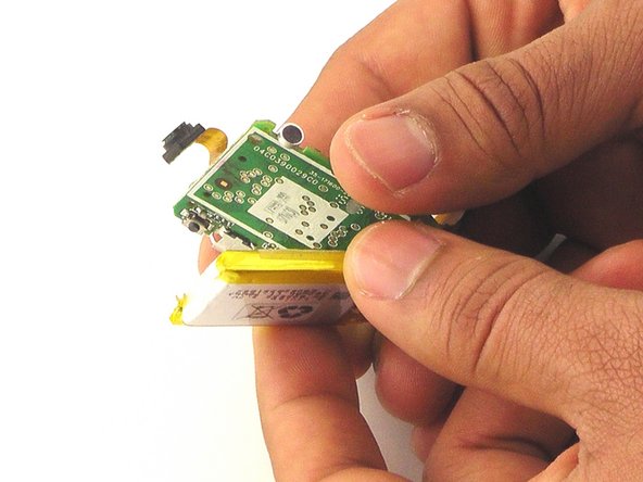

  10. Vtech Kidizoom Smart Watch DX Battery Replacement, Battery: crwdns2935265:010crwdnd2935265:01crwdnd2935265:02crwdne2935265:0 Vtech Kidizoom Smart Watch DX Battery Replacement, Battery: crwdns2935265:010crwdnd2935265:02crwdnd2935265:02crwdne2935265:0
    • Using the plastic opening tool, gently pry the edges of the battery away from from the circuit board.
    • There is a thin layer of adhesive holding the battery to the circuit board. This will remain sticky after prying.
  11. Vtech Kidizoom Smart Watch DX Battery Replacement: crwdns2935265:011crwdnd2935265:01crwdnd2935265:01crwdne2935265:0
    • De-solder the red battery wire from the circuit board.
  12. Vtech Kidizoom Smart Watch DX Battery Replacement: crwdns2935265:012crwdnd2935265:01crwdnd2935265:01crwdne2935265:0
    • Repeat the de-soldering for the black (ground) wire.
  13. Vtech Kidizoom Smart Watch DX Battery Replacement: crwdns2935265:013crwdnd2935265:01crwdnd2935265:01crwdne2935265:0
    • Pull the battery free, and wait for the solder to cool before handling further.
