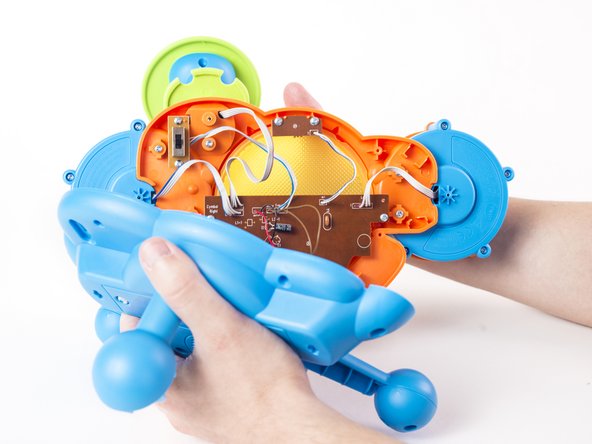

    • Using a Phillips #2 screwdriver, loosen and remove the six 14 mm screws.
  6. Vtech Kidibeats Drum Set Green Cymbal Replacement: crwdns2935265:06crwdnd2935265:01crwdnd2935265:02crwdne2935265:0 Vtech Kidibeats Drum Set Green Cymbal Replacement: crwdns2935265:06crwdnd2935265:02crwdnd2935265:02crwdne2935265:0
    • With your hands, separate the bottom panel from the drum set.
    • When removing the bottom panel, be careful not to pull too hard in order to prevent damaging the connections from the motherboard to the speaker and power source.
