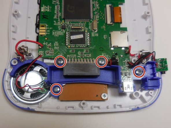

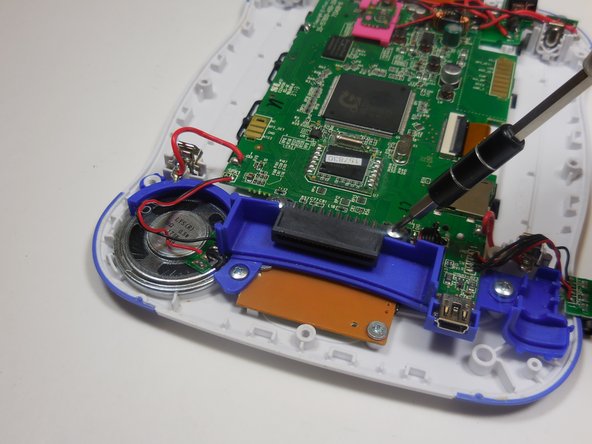

    • After you disassemble the device, put the back panel to the side and move your attention to the front piece.
    • Remove the four screws using a PH00 screwdriver.
  6. Vtech Innotab 3 Speaker Replacement: crwdns2935265:06crwdnd2935265:01crwdnd2935265:02crwdne2935265:0 Vtech Innotab 3 Speaker Replacement: crwdns2935265:06crwdnd2935265:02crwdnd2935265:02crwdne2935265:0

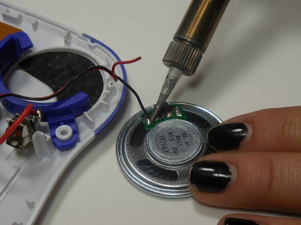

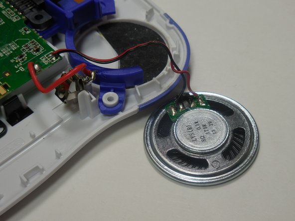

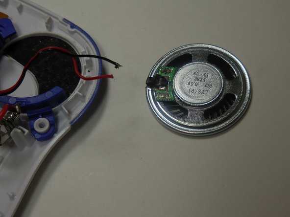

    • Using a nylon or metal spudger, lift the blue plastic piece upwards.
    • Keeping the plastic piece lifted, carefully pinch the edge of the speaker and remove it.
    • Be sure not to tug on the speaker too violently to prevent tearing a wiring from its solder.
