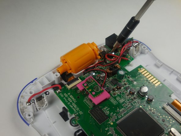

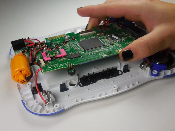

  5. Vtech Innotab 3 Microphone Replacement, Microphone: crwdns2935265:05crwdnd2935265:01crwdnd2935265:03crwdne2935265:0 Vtech Innotab 3 Microphone Replacement, Microphone: crwdns2935265:05crwdnd2935265:02crwdnd2935265:03crwdne2935265:0 Vtech Innotab 3 Microphone Replacement, Microphone: crwdns2935265:05crwdnd2935265:03crwdnd2935265:03crwdne2935265:0
    • Remove the four 7.6 mm screws using a PH00 screwdriver.
    • Lift up the circuit board from the device.

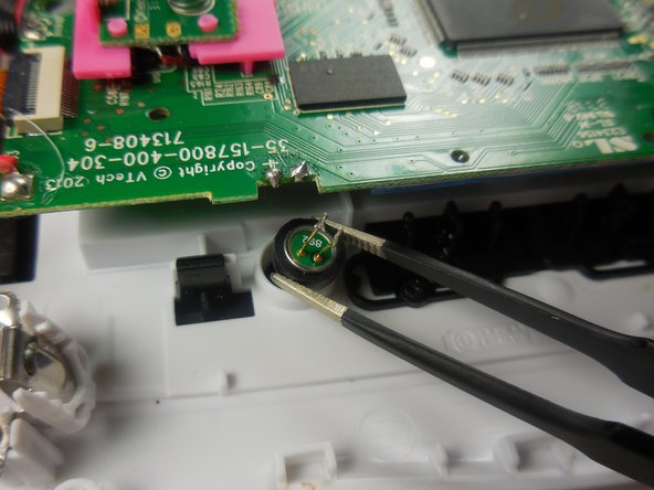

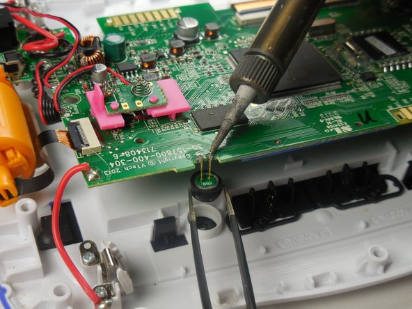

    • To replace the microphone, desolder the two connections that connect the speaker to the device.
    • Use tweezers to keep the microphone steady as you desolder the connections.
    • This is a tricky step. Refer to this guide to learn how to solder: How To Solder and Desolder Connections
