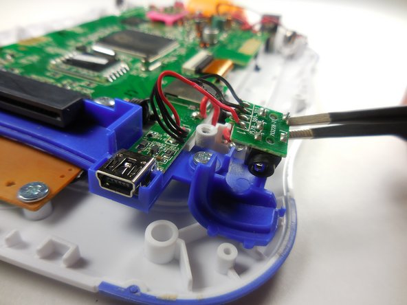

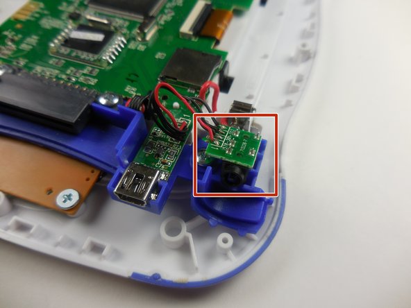

  5. Vtech Innotab 3 Headphone Port Replacement, Headphone Port: crwdns2935265:05crwdnd2935265:01crwdnd2935265:03crwdne2935265:0 Vtech Innotab 3 Headphone Port Replacement, Headphone Port: crwdns2935265:05crwdnd2935265:02crwdnd2935265:03crwdne2935265:0 Vtech Innotab 3 Headphone Port Replacement, Headphone Port: crwdns2935265:05crwdnd2935265:03crwdnd2935265:03crwdne2935265:0
    • On the front panel of the device, the headphone poet is located at the bottom right corner of the device, opposte of the speaker.
    • Using tweezers, lift up to remove the headphone port from its holding.
    • Be careful not to tug too hard when removing the headphone port for you may disconnect the wires from the solder

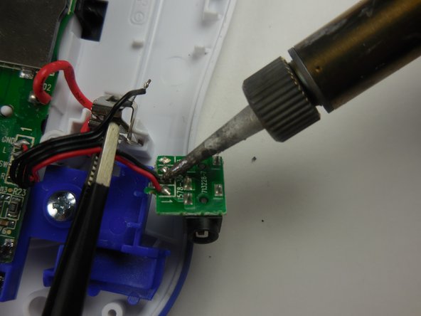

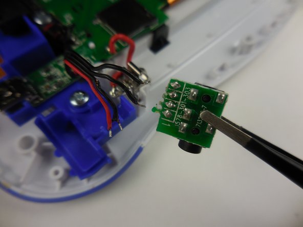

  6. Vtech Innotab 3 Headphone Port Replacement: crwdns2935265:06crwdnd2935265:01crwdnd2935265:03crwdne2935265:0 Vtech Innotab 3 Headphone Port Replacement: crwdns2935265:06crwdnd2935265:02crwdnd2935265:03crwdne2935265:0 Vtech Innotab 3 Headphone Port Replacement: crwdns2935265:06crwdnd2935265:03crwdnd2935265:03crwdne2935265:0
    • Use tweezers to hold the four connecting wires away from the headphone port.
    • Desolder the four wires connected to the headphone port.
    • This is a tricky step. Refer to this guide to learn how to solder: How To Solder and Desolder Connections
