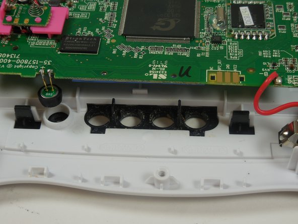

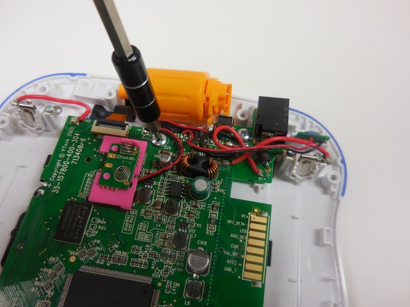

    1. Vtech Innotab 3 Button Replacement, Button Repair: crwdns2935265:05crwdnd2935265:01crwdnd2935265:03crwdne2935265:0 Vtech Innotab 3 Button Replacement, Button Repair: crwdns2935265:05crwdnd2935265:02crwdnd2935265:03crwdne2935265:0 Vtech Innotab 3 Button Replacement, Button Repair: crwdns2935265:05crwdnd2935265:03crwdnd2935265:03crwdne2935265:0
      • Remove the four 7.6 mm screws using a PH00 screwdriver.
      • Lift the circuit board up to give yourself room to remove the buttons.

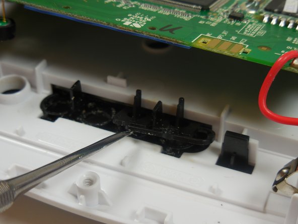

    2. Vtech Innotab 3 Button Replacement: crwdns2935265:06crwdnd2935265:01crwdnd2935265:03crwdne2935265:0 Vtech Innotab 3 Button Replacement: crwdns2935265:06crwdnd2935265:02crwdnd2935265:03crwdne2935265:0 Vtech Innotab 3 Button Replacement: crwdns2935265:06crwdnd2935265:03crwdnd2935265:03crwdne2935265:0
      • Using a nylon or metal spudger, lift up the buttons to remove them from their holding. they should just pop out of place.
      • The buttons are joined together in pairs, be sure not to break them apart during removal.
