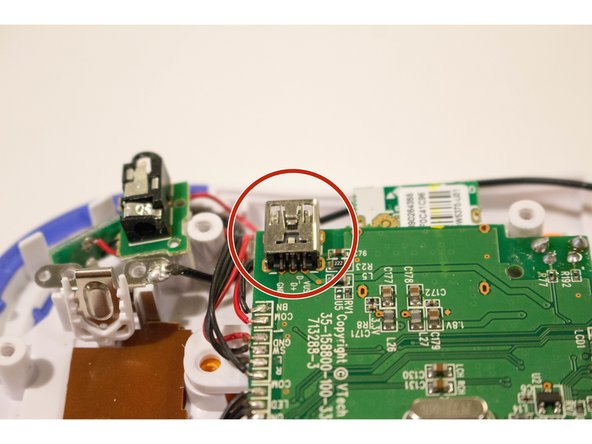

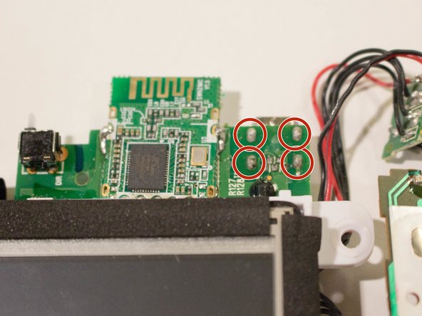

  7. Vtech InnoTab 3S USB Port Replacement, USB Port: crwdns2935265:07crwdnd2935265:01crwdnd2935265:03crwdne2935265:0 Vtech InnoTab 3S USB Port Replacement, USB Port: crwdns2935265:07crwdnd2935265:02crwdnd2935265:03crwdne2935265:0 Vtech InnoTab 3S USB Port Replacement, USB Port: crwdns2935265:07crwdnd2935265:03crwdnd2935265:03crwdne2935265:0
    • The mini USB port is located near the top of the device and is secured by four metal prongs underneath the port.
    • Facing the underside of the USB port, solder the metal prongs securing the USB port to the device.
    • Avoid forceful movements when soldering to prevent damage of device components and avoid personal injury.
