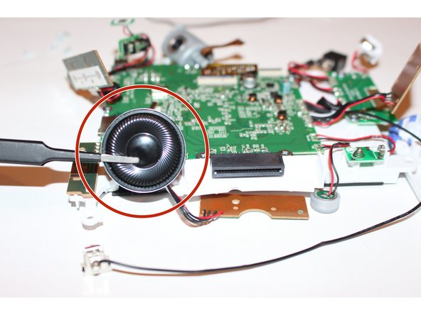

  7. Vtech InnoTab 3S Speaker Replacement, Speaker: crwdns2935265:07crwdnd2935265:01crwdnd2935265:02crwdne2935265:0 Vtech InnoTab 3S Speaker Replacement, Speaker: crwdns2935265:07crwdnd2935265:02crwdnd2935265:02crwdne2935265:0
    • Looking at the front of the motherboard, the speakers are located in the bottom left of the device. They are shaped like a large black circle.
    • Using a soldering iron, heat the connections securing the speakers to the motherboard of the device.
    • Remove the connections on the motherboard to detach the speaker.
    • Avoid forceful movements when soldering to prevent damage of device components and avoid personal injury.
