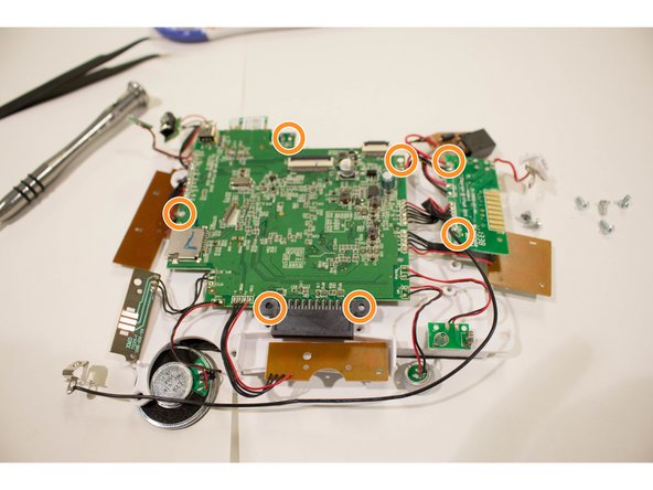

  5. Vtech InnoTab 3S Screen Replacement, Motherboard: crwdns2935265:05crwdnd2935265:01crwdnd2935265:02crwdne2935265:0 Vtech InnoTab 3S Screen Replacement, Motherboard: crwdns2935265:05crwdnd2935265:02crwdnd2935265:02crwdne2935265:0
    • Remove the six screws that secure the motherboard to the front panel of the device using a Phillips #1 screwdriver.
    • Remove the other 5mm screws that secure the charger port and the buttons to the inside of the front panel.
    • Remove the six 3 mm screws securing the battery clip.

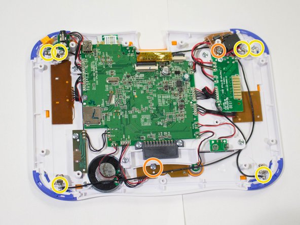

  6. Vtech InnoTab 3S Screen Replacement: crwdns2935265:06crwdnd2935265:01crwdnd2935265:01crwdne2935265:0
    • Using the tweezers, remove one battery clip from each corner (four total) of the Vtech InnoTab 3s.
    • With the tweezers, unsecure the charging port, headphone port, and the light switch button from the front panel of the device.
    • Potential for device damage: Avoid forceful movements when removing the motherboard to prevent damage of device components.

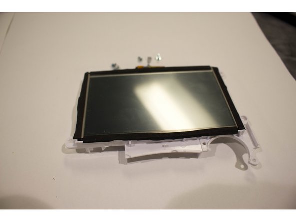

  7. Vtech InnoTab 3S Screen Replacement, Screen: crwdns2935265:07crwdnd2935265:01crwdnd2935265:03crwdne2935265:0 Vtech InnoTab 3S Screen Replacement, Screen: crwdns2935265:07crwdnd2935265:02crwdnd2935265:03crwdne2935265:0 Vtech InnoTab 3S Screen Replacement, Screen: crwdns2935265:07crwdnd2935265:03crwdnd2935265:03crwdne2935265:0

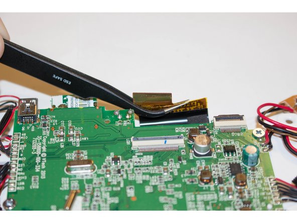

    • Open the clip holding the screen plug with the yellow film.
    • The clip securing the screen is located at the top of the motherboard.
    • Remove all seven of the 5mm screws on the motherboard to separate the motherboard from the screen.
  8. Vtech InnoTab 3S Screen Replacement: crwdns2935265:08crwdnd2935265:01crwdnd2935265:02crwdne2935265:0 Vtech InnoTab 3S Screen Replacement: crwdns2935265:08crwdnd2935265:02crwdnd2935265:02crwdne2935265:0
    • Avoid forceful movements when separating the screen from the motherboard.
    • Carefully separate the motherboard from the device screen. Replace the damaged screen with an operational one.
