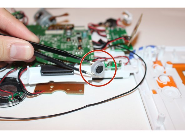

  7. Vtech InnoTab 3S Microphone Replacement, Microphone: crwdns2935265:07crwdnd2935265:01crwdnd2935265:02crwdne2935265:0 Vtech InnoTab 3S Microphone Replacement, Microphone: crwdns2935265:07crwdnd2935265:02crwdnd2935265:02crwdne2935265:0
    • The microphone is on the bottom right of the device, and shaped like a small white circle. There are two prongs securing the microphone to the device.
    • Solder the prongs to unsecure the microphone from the device.
    • Avoid forceful movements when soldering to prevent damage to device components and personal injury.
    • Using the tweezers carefully remove the microphone from the device.
