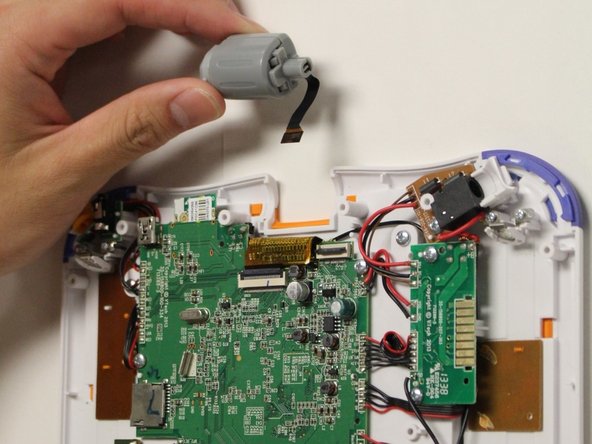

    4. Vtech InnoTab 3S Camera Replacement: crwdns2935265:04crwdnd2935265:01crwdnd2935265:01crwdne2935265:0
      • Carefully remove the rear panel from the front panel of the device.
      • Once the rear panel is removed, you'll be able to see the motherboard and other components within the Vtech InnoTab 3s.
    1. Vtech InnoTab 3S Camera Replacement, Camera: crwdns2935265:05crwdnd2935265:01crwdnd2935265:02crwdne2935265:0 Vtech InnoTab 3S Camera Replacement, Camera: crwdns2935265:05crwdnd2935265:02crwdnd2935265:02crwdne2935265:0
      • Using the tip of your finger, carefully pull the clip upwards to release the camera connection from the motherboard.
      • The connection between the motherboard and the camera is located at the near the top of the device.
      • Remove the camera and the connecting wire from the the clip and attach the replacement cameras connection to the latch on the motherboard.
      • Carefully lower the latch until you hear a click to secure the new camera to the device.
      • Pulling or tugging on the connection between the camera and the circuit board may cause damage to the connection.
