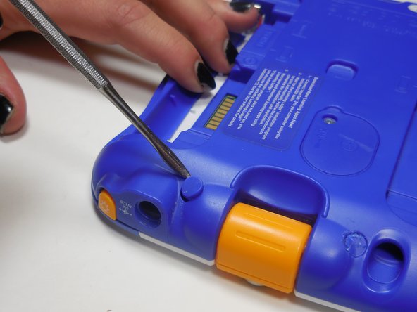

  3. Vtech InnoTab 3 Rear Panel Diassembly: crwdns2935265:03crwdnd2935265:01crwdnd2935265:03crwdne2935265:0 Vtech InnoTab 3 Rear Panel Diassembly: crwdns2935265:03crwdnd2935265:02crwdnd2935265:03crwdne2935265:0 Vtech InnoTab 3 Rear Panel Diassembly: crwdns2935265:03crwdnd2935265:03crwdnd2935265:03crwdne2935265:0
    • There are three hidden screws on the back of the device, two at the top and one near the bottom.
    • Using a nylon or metal spudger, remove the three caps that hide the screws.
    • Remove the 5mm screw near the bottom and the two 7.6mm at the top using a PH00 screwdriver.
