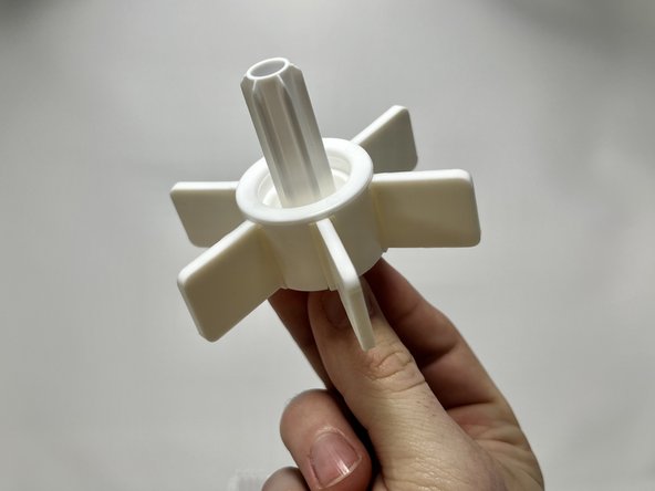

  2. Voluas VL001 Silicone Hopper Feeder Replacement, Silicone Hopper Feeder: crwdns2935265:02crwdnd2935265:01crwdnd2935265:03crwdne2935265:0 Voluas VL001 Silicone Hopper Feeder Replacement, Silicone Hopper Feeder: crwdns2935265:02crwdnd2935265:02crwdnd2935265:03crwdne2935265:0 Voluas VL001 Silicone Hopper Feeder Replacement, Silicone Hopper Feeder: crwdns2935265:02crwdnd2935265:03crwdnd2935265:03crwdne2935265:0
    • Grab the spindle from the bottom.
    • This will prevent the feeder from spinning while you loosen the screw.
    • Using a Phillips #2 screwdriver, remove the single 11.6 mm screw in the center of the topside of the feeder mechanism.
    • Once the screw is removed, grab the three-pronged silicone agitator and remove it from the feeder.

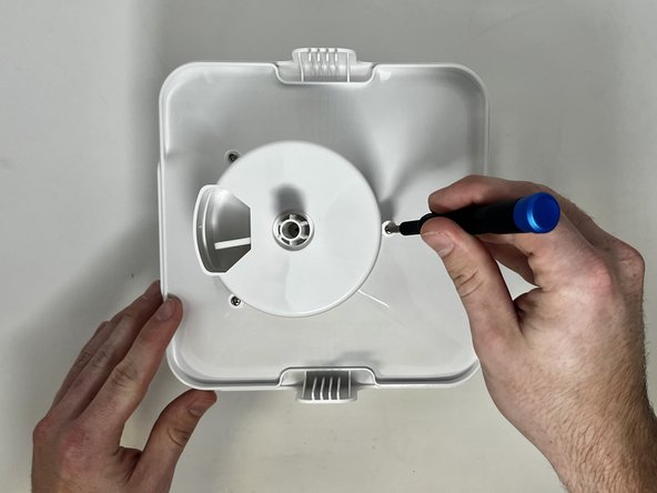

  3. Voluas VL001 Silicone Hopper Feeder Replacement: crwdns2935265:03crwdnd2935265:01crwdnd2935265:03crwdne2935265:0 Voluas VL001 Silicone Hopper Feeder Replacement: crwdns2935265:03crwdnd2935265:02crwdnd2935265:03crwdne2935265:0 Voluas VL001 Silicone Hopper Feeder Replacement: crwdns2935265:03crwdnd2935265:03crwdnd2935265:03crwdne2935265:0
    • Flip the storage tank over so that the bottom side is facing up.
    • Using a Phillips #2 screwdriver, remove the three 11.3 mm screws that hold the plastic cap onto the bottom of the tank.

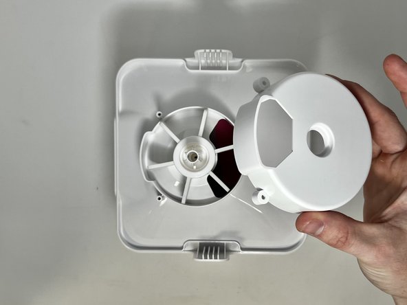

    • Lift the plastic cap off the tank.
  4. Voluas VL001 Silicone Hopper Feeder Replacement: crwdns2935265:04crwdnd2935265:01crwdnd2935265:02crwdne2935265:0 Voluas VL001 Silicone Hopper Feeder Replacement: crwdns2935265:04crwdnd2935265:02crwdnd2935265:02crwdne2935265:0
    • Firmly grab the spindle of the mechanism and remove it from the bottom of the tank.
