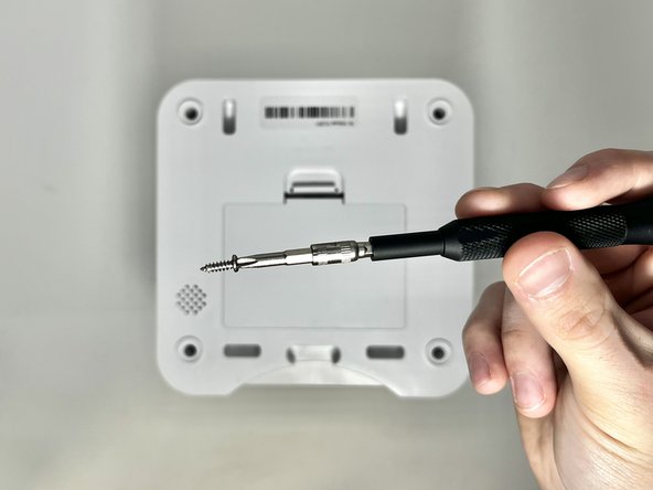

  4. Voluas VL001 Screen/Motherboard Assembly Replacement: crwdns2935265:04crwdnd2935265:01crwdnd2935265:02crwdne2935265:0 Voluas VL001 Screen/Motherboard Assembly Replacement: crwdns2935265:04crwdnd2935265:02crwdnd2935265:02crwdne2935265:0
    • Remove four screws from the corners of the device using a Phillips #2 screwdriver.
    • These holes were previously covered by the rubber feet.
    • Using the magnetic tip of the screwdriver, carefully lift the screw out of the hole.

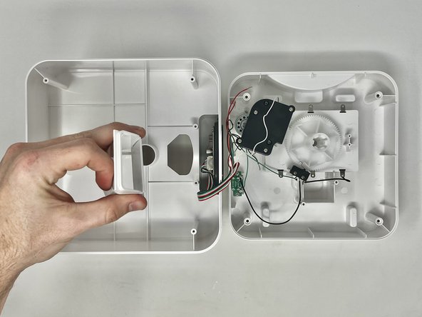

  5. Voluas VL001 Screen/Motherboard Assembly Replacement: crwdns2935265:05crwdnd2935265:01crwdnd2935265:01crwdne2935265:0
    • Turn the device over so it is oriented right-side up.
    • Lift the top part of the feeder off, exposing the mechanisms that run the feeder.

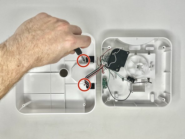

  6. Voluas VL001 Screen/Motherboard Assembly Replacement, Screen/Motherboard Assembly: crwdns2935265:06crwdnd2935265:01crwdnd2935265:02crwdne2935265:0 Voluas VL001 Screen/Motherboard Assembly Replacement, Screen/Motherboard Assembly: crwdns2935265:06crwdnd2935265:02crwdnd2935265:02crwdne2935265:0
    • With the top part of the feeder sitting upside down, you can remove the chute.
    • Using a Phillips #2 screwdriver, remove the two 11.1 mm screws on either side of the chute.
  7. Voluas VL001 Screen/Motherboard Assembly Replacement: crwdns2935265:07crwdnd2935265:01crwdnd2935265:02crwdne2935265:0 Voluas VL001 Screen/Motherboard Assembly Replacement: crwdns2935265:07crwdnd2935265:02crwdnd2935265:02crwdne2935265:0
    • Grab the feeder chute on both sides and lift it off to remove it from the feeder.

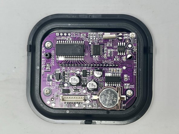

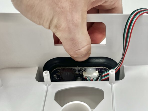

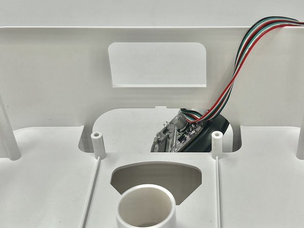

  8. Voluas VL001 Screen/Motherboard Assembly Replacement: crwdns2935265:08crwdnd2935265:01crwdnd2935265:03crwdne2935265:0 Voluas VL001 Screen/Motherboard Assembly Replacement: crwdns2935265:08crwdnd2935265:02crwdnd2935265:03crwdne2935265:0 Voluas VL001 Screen/Motherboard Assembly Replacement: crwdns2935265:08crwdnd2935265:03crwdnd2935265:03crwdne2935265:0
    • Using your finger, depress the tab that holds the assembly onto the device.
    • While pushing the tab down, push the screen out of the device.

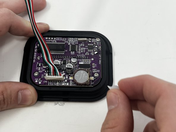

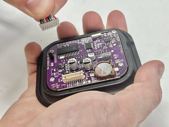

  9. Voluas VL001 Screen/Motherboard Assembly Replacement: crwdns2935265:09crwdnd2935265:01crwdnd2935265:03crwdne2935265:0 Voluas VL001 Screen/Motherboard Assembly Replacement: crwdns2935265:09crwdnd2935265:02crwdnd2935265:03crwdne2935265:0 Voluas VL001 Screen/Motherboard Assembly Replacement: crwdns2935265:09crwdnd2935265:03crwdnd2935265:03crwdne2935265:0
    • Using an opening tool, pry the dried silicone from around the connector.
    • Because you are working around the motherboard, try to limit how much you use its surface for leverage. It is a fragile part and can damage easily.
    • If needed, peel any remaining glue off with your fingers.

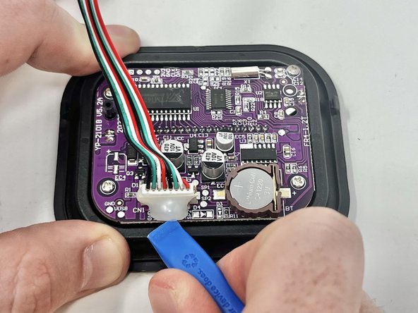

  10. Voluas VL001 Screen/Motherboard Assembly Replacement: crwdns2935265:010crwdnd2935265:01crwdnd2935265:03crwdne2935265:0 Voluas VL001 Screen/Motherboard Assembly Replacement: crwdns2935265:010crwdnd2935265:02crwdnd2935265:03crwdne2935265:0 Voluas VL001 Screen/Motherboard Assembly Replacement: crwdns2935265:010crwdnd2935265:03crwdnd2935265:03crwdne2935265:0
    • Firmly grab the connector, just above the plastic end, and pull firmly to remove.
