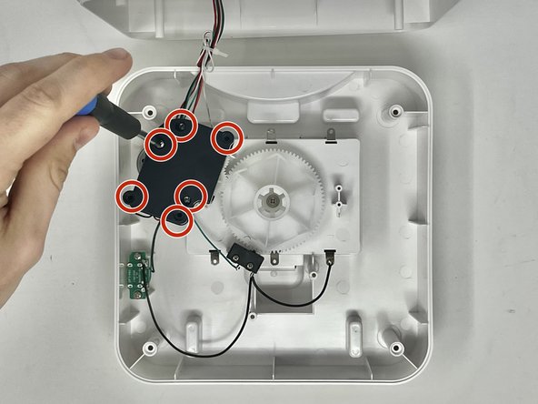

  6. Voluas VL001 Motor Assembly Gears Replacement, Motor Assembly Gears: crwdns2935265:06crwdnd2935265:01crwdnd2935265:03crwdne2935265:0 Voluas VL001 Motor Assembly Gears Replacement, Motor Assembly Gears: crwdns2935265:06crwdnd2935265:02crwdnd2935265:03crwdne2935265:0 Voluas VL001 Motor Assembly Gears Replacement, Motor Assembly Gears: crwdns2935265:06crwdnd2935265:03crwdnd2935265:03crwdne2935265:0
    • Using a Phillips #2 screwdriver, remove the six screws that hold the motor housing on to the device.

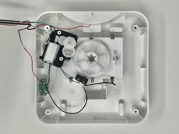

  7. Voluas VL001 Motor Assembly Gears Replacement: crwdns2935265:07crwdnd2935265:01crwdnd2935265:01crwdne2935265:0
    • Lift the electric motor from its housing and move it aside.

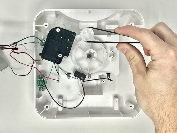

    • Use the tweezers to remove the first gear that is placed on top.
  9. Voluas VL001 Motor Assembly Gears Replacement: crwdns2935265:09crwdnd2935265:01crwdnd2935265:02crwdne2935265:0 Voluas VL001 Motor Assembly Gears Replacement: crwdns2935265:09crwdnd2935265:02crwdnd2935265:02crwdne2935265:0

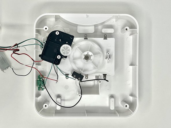

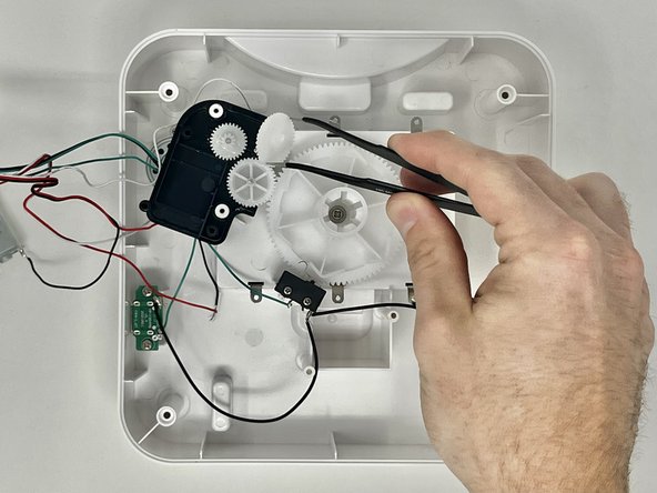

    • Use the tweezers to gently remove the second gear.
  10. Voluas VL001 Motor Assembly Gears Replacement: crwdns2935265:010crwdnd2935265:01crwdnd2935265:02crwdne2935265:0 Voluas VL001 Motor Assembly Gears Replacement: crwdns2935265:010crwdnd2935265:02crwdnd2935265:02crwdne2935265:0
    • Use the tweezers to gently remove the third gear.
