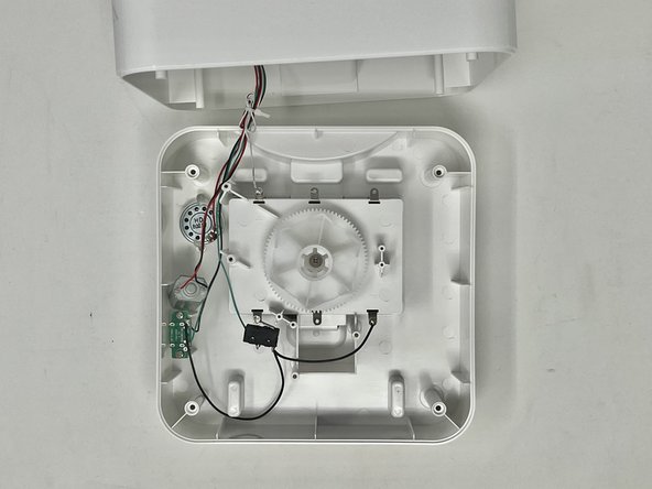

  5. Voluas VL001 Main Drive Gear Replacement: crwdns2935265:05crwdnd2935265:01crwdnd2935265:01crwdne2935265:0
    • Turn the device over so it is oriented right-side up.
    • Lift the top part of the feeder off, exposing the mechanisms that run the feeder.

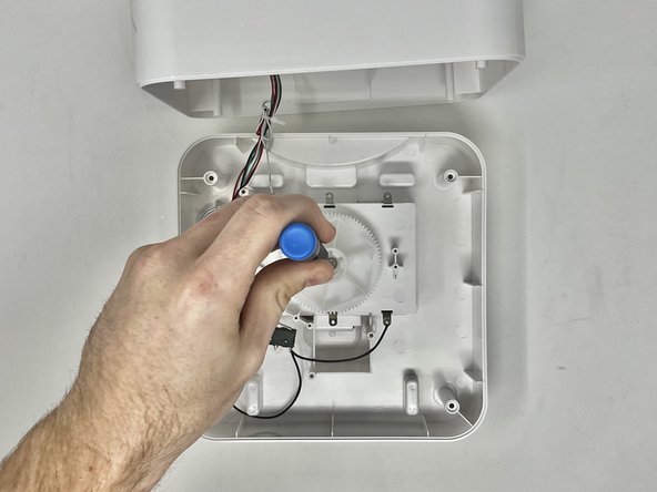

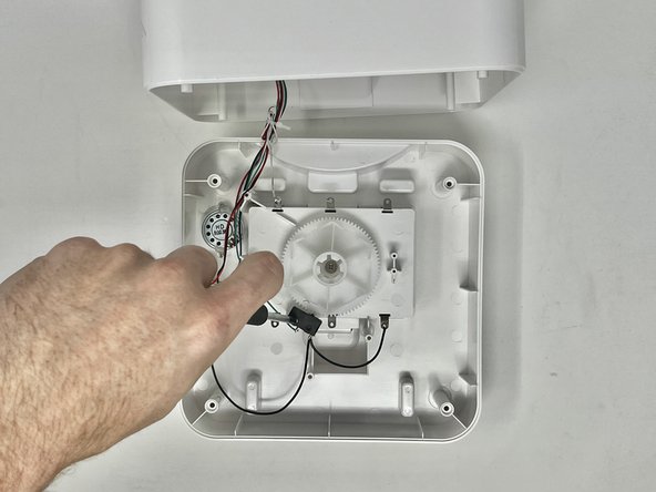

  6. Voluas VL001 Main Drive Gear Replacement, Main Drive Gear: crwdns2935265:06crwdnd2935265:01crwdnd2935265:03crwdne2935265:0 Voluas VL001 Main Drive Gear Replacement, Main Drive Gear: crwdns2935265:06crwdnd2935265:02crwdnd2935265:03crwdne2935265:0 Voluas VL001 Main Drive Gear Replacement, Main Drive Gear: crwdns2935265:06crwdnd2935265:03crwdnd2935265:03crwdne2935265:0
    • Remove the two 11 mm screws that attach the portion switch to the device using a #2 Phillips screwdriver.
  7. Voluas VL001 Main Drive Gear Replacement: crwdns2935265:07crwdnd2935265:01crwdnd2935265:02crwdne2935265:0 Voluas VL001 Main Drive Gear Replacement: crwdns2935265:07crwdnd2935265:02crwdnd2935265:02crwdne2935265:0
    • Using a Phillips #2 screwdriver, remove the single 13 mm screw that is found in the center of the main drive gear shaft.

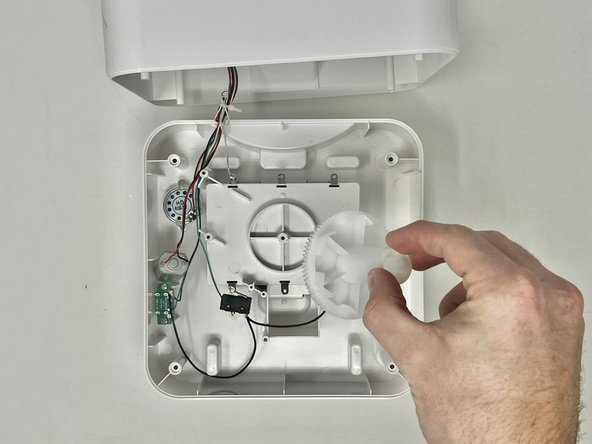

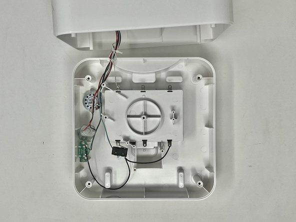

  8. Voluas VL001 Main Drive Gear Replacement: crwdns2935265:08crwdnd2935265:01crwdnd2935265:03crwdne2935265:0 Voluas VL001 Main Drive Gear Replacement: crwdns2935265:08crwdnd2935265:02crwdnd2935265:03crwdne2935265:0 Voluas VL001 Main Drive Gear Replacement: crwdns2935265:08crwdnd2935265:03crwdnd2935265:03crwdne2935265:0
    • Firmly grab the gear and remove it from the device.
