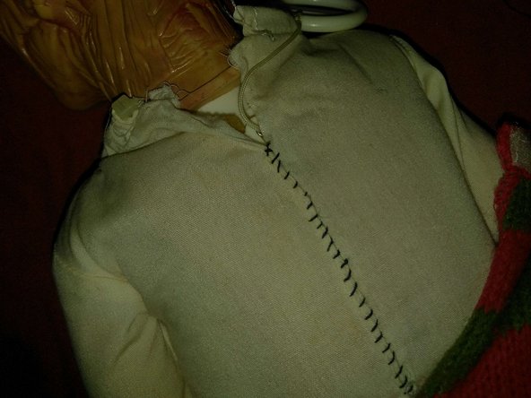

  2. Voice Box Repair, Not Quite What He Seams: crwdns2935265:02crwdnd2935265:01crwdnd2935265:02crwdne2935265:0 Voice Box Repair, Not Quite What He Seams: crwdns2935265:02crwdnd2935265:02crwdnd2935265:02crwdne2935265:0
    • Take Out The Seams
    • Use your seam ripper & take out the large stiches from top going down, you don't need to take them all out just the top 3/4-ish of his back

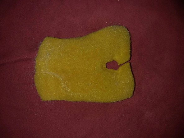

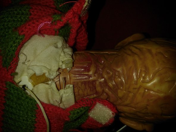

    • Peel Open The Back & Dig In!
    • First, gently pull out the foam covering, then you will see the voice box (Flesh colored plastic box) hidden behind the mounting plate (The white plate attached to the metal rods) in front of you

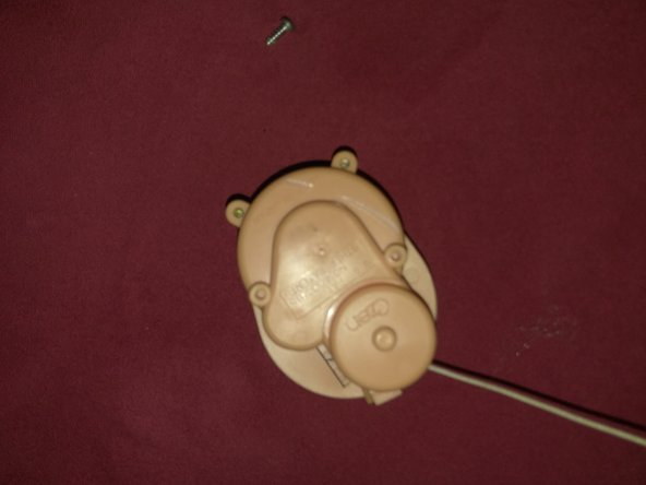

    • Take out the two screws highlighted in the image with your #1 Philips
  4. Voice Box Repair, What's The Problem Freddy, Cat Got Your Voice Box?: crwdns2935265:04crwdnd2935265:01crwdnd2935265:03crwdne2935265:0 Voice Box Repair, What's The Problem Freddy, Cat Got Your Voice Box?: crwdns2935265:04crwdnd2935265:02crwdnd2935265:03crwdne2935265:0 Voice Box Repair, What's The Problem Freddy, Cat Got Your Voice Box?: crwdns2935265:04crwdnd2935265:03crwdnd2935265:03crwdne2935265:0
    • Gently Pull The Unmounted Voice Box Out From The Side
    • This is why you have to undo the stitching, slide it out via the side between the open back & the metal & plastic frame
    • (Yes the string stays in place, yes that's fine)

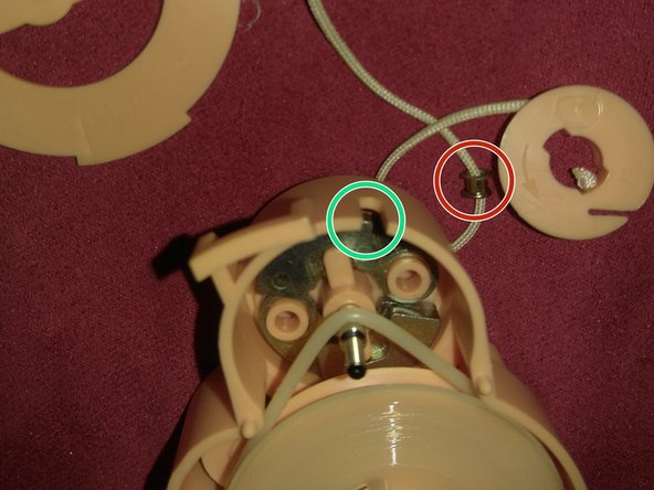

    • With one hand, hold the thread tight & with the other keep the base of it steady, you need to find the slot point in the center of the spindle (Picture one, red circle) & quickly let go of the thread on the bottom as you press it down onto that (making sure it does not unravel anywhere along the way)
    • Then, without removing the pressure from the top of the spindle you need to replace the metal thing (picture one, green circle), pressing it firmly down to make sure it stays tight in place
    • Lastly, make sure the little metal bit (picture two, red circle) is in place at the output slot (picture two, green circle)

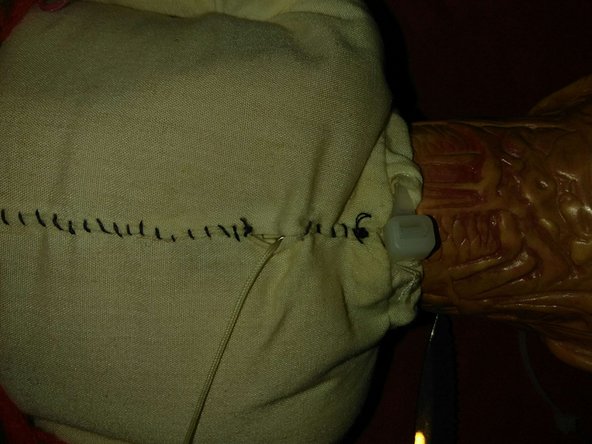

    • Make sure all his stuffing is in place before you take that needle & stich him back up, pretty much the same as it was before (Although I did tighter, more even stiches)
  16. Voice Box Repair, Zip It Freddy (Tight That Is): crwdns2935265:016crwdnd2935265:01crwdnd2935265:02crwdne2935265:0 Voice Box Repair, Zip It Freddy (Tight That Is): crwdns2935265:016crwdnd2935265:02crwdnd2935265:02crwdne2935265:0
    • Time to finish up!
    • Add a new zip tie in the slot around his neck where the last one was & pull it tight
    • Cut the excess tie off & finish sewing up above the pull string hole
