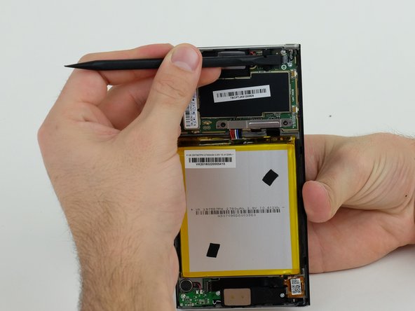

    1. Vizio SmartCast Tablet Remote XR6P Power Button Replacement, Power Button: crwdns2935265:04crwdnd2935265:01crwdnd2935265:01crwdne2935265:0
      • Using the pointy end of the black plastic spudger, carefully remove the black tape covering the plug.
    2. Vizio SmartCast Tablet Remote XR6P Power Button Replacement: crwdns2935265:05crwdnd2935265:01crwdnd2935265:02crwdne2935265:0 Vizio SmartCast Tablet Remote XR6P Power Button Replacement: crwdns2935265:05crwdnd2935265:02crwdnd2935265:02crwdne2935265:0
      • Use the flat end of the spudger to pry the ribbon holder upwards.
    3. Vizio SmartCast Tablet Remote XR6P Power Button Replacement: crwdns2935265:06crwdnd2935265:01crwdnd2935265:01crwdne2935265:0
      • Obtain the tweezers and gently pull the black ribbon until it comes out of the holder.
    4. Vizio SmartCast Tablet Remote XR6P Power Button Replacement: crwdns2935265:07crwdnd2935265:01crwdnd2935265:01crwdne2935265:0
      • Continue pulling the black tab until you have completely removed the power button from the device.
