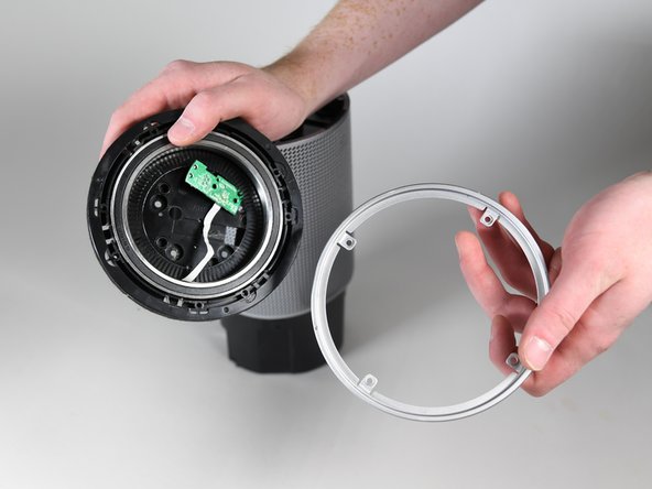

  3. Vizio SmartCast Crave 360 Speaker Ring Replacement: crwdns2935265:03crwdnd2935265:01crwdnd2935265:01crwdne2935265:0
    • Remove the four 5mm screws that connect the inner bearing to the outer ring using a Phillips #000 screwdriver.
  4. Vizio SmartCast Crave 360 Speaker Ring Replacement: crwdns2935265:04crwdnd2935265:01crwdnd2935265:02crwdne2935265:0 Vizio SmartCast Crave 360 Speaker Ring Replacement: crwdns2935265:04crwdnd2935265:02crwdnd2935265:02crwdne2935265:0
    • Take the outer ring and inner bearing off of the speaker.
    • Remove the outer ring from the inner bearing and plastic disc.
  5. Vizio SmartCast Crave 360 Speaker Ring Replacement: crwdns2935265:05crwdnd2935265:01crwdnd2935265:01crwdne2935265:0
    • Remove the inner bearing from the plastic disc so that all three components of the speaker ring are separated.
