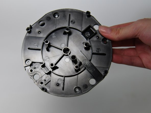

    • Flip the speaker to access the top.
    • Remove the eight 10 mm screws from the plastic disc inside the grey speaker cage using a Phillips #000 screwdriver.
    • Remove the plastic disc from the speaker cage.

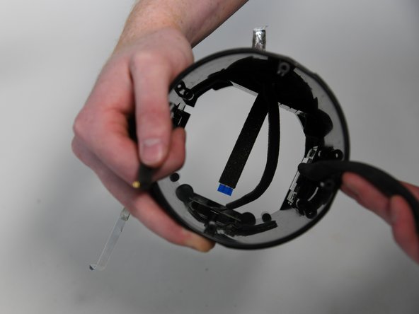

  7. Vizio SmartCast Crave 360 Battery Replacement: crwdns2935265:07crwdnd2935265:01crwdnd2935265:01crwdne2935265:0
    • Lift the grey speaker cage to reveal a black plastic cylinder that contains the battery.

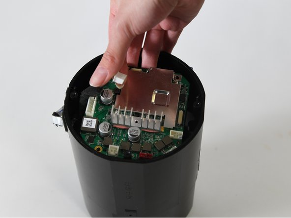

    • Disconnect the wire that connects the motherboard to the battery.
  9. Vizio SmartCast Crave 360 Battery Replacement: crwdns2935265:09crwdnd2935265:01crwdnd2935265:02crwdne2935265:0 Vizio SmartCast Crave 360 Battery Replacement: crwdns2935265:09crwdnd2935265:02crwdnd2935265:02crwdne2935265:0
    • Remove the motherboard and battery from the plastic cylinder.
  10. Vizio SmartCast Crave 360 Battery Replacement: crwdns2935265:010crwdnd2935265:01crwdnd2935265:01crwdne2935265:0
    • Remove the four 5 mm screws from the motherboard using a Phillips #000 screwdriver.
  11. Vizio SmartCast Crave 360 Battery Replacement: crwdns2935265:011crwdnd2935265:01crwdnd2935265:01crwdne2935265:0
    • Remove the motherboard from the battery.
