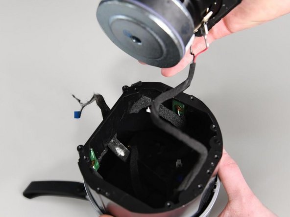

  4. Vizio SmartCast Crave 360 Bass Replacement, Bass: crwdns2935265:04crwdnd2935265:01crwdnd2935265:02crwdne2935265:0 Vizio SmartCast Crave 360 Bass Replacement, Bass: crwdns2935265:04crwdnd2935265:02crwdnd2935265:02crwdne2935265:0
    • Remove the collar that wraps around the bass component.
    • Once the collar is removed, the speaker should appear similar to the speaker shown in the second photo.
  5. Vizio SmartCast Crave 360 Bass Replacement: crwdns2935265:05crwdnd2935265:01crwdnd2935265:03crwdne2935265:0 Vizio SmartCast Crave 360 Bass Replacement: crwdns2935265:05crwdnd2935265:02crwdnd2935265:03crwdne2935265:0 Vizio SmartCast Crave 360 Bass Replacement: crwdns2935265:05crwdnd2935265:03crwdnd2935265:03crwdne2935265:0

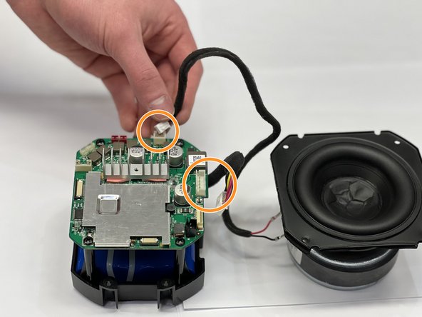

    • Remove the four 10 mm screws with that connect the bass to the rest of the speaker using a Phillips #000 screwdriver.
    • Take the bass component out of the speaker.
    • Disconnect the wiring that runs into the bass component.
    • The bass is now removed.
