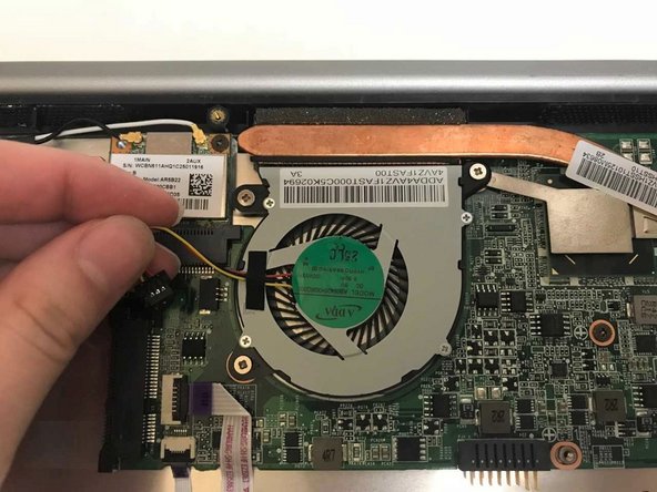

    1. Vizio CT15 Keyboard Replacement, CPU Fan: crwdns2935265:08crwdnd2935265:01crwdnd2935265:02crwdne2935265:0 Vizio CT15 Keyboard Replacement, CPU Fan: crwdns2935265:08crwdnd2935265:02crwdnd2935265:02crwdne2935265:0
      • Unplug the fan from the motherboard.

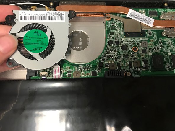

    2. Vizio CT15 Keyboard Replacement: crwdns2935265:09crwdnd2935265:01crwdnd2935265:02crwdne2935265:0 Vizio CT15 Keyboard Replacement: crwdns2935265:09crwdnd2935265:02crwdnd2935265:02crwdne2935265:0
      • Remove the three Phillips #0 screws.
      • Pull the fan out to remove.

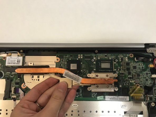

    1. Vizio CT15 Keyboard Replacement, Keyboard: crwdns2935265:010crwdnd2935265:01crwdnd2935265:02crwdne2935265:0 Vizio CT15 Keyboard Replacement, Keyboard: crwdns2935265:010crwdnd2935265:02crwdnd2935265:02crwdne2935265:0
      • Remove the four Philips #0 screws from the heatsink.
      • Pull up and out to remove the heatsink from the laptop.

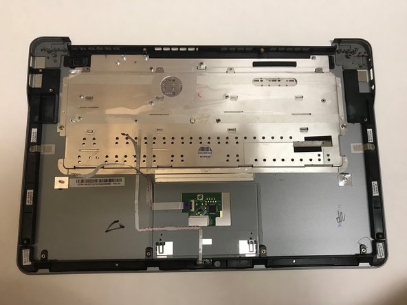

    2. Vizio CT15 Keyboard Replacement: crwdns2935265:011crwdnd2935265:01crwdnd2935265:02crwdne2935265:0 Vizio CT15 Keyboard Replacement: crwdns2935265:011crwdnd2935265:02crwdnd2935265:02crwdne2935265:0
      • Remove the eight Phillips #0 screws from the motherboard.
      • Lift the motherboard up and out to remove it from the laptop.

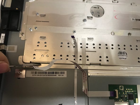

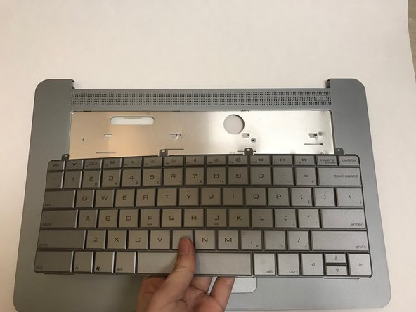

    3. Vizio CT15 Keyboard Replacement: crwdns2935265:012crwdnd2935265:01crwdnd2935265:01crwdne2935265:0
      • Remove the four Phillips #00 screws that hold the keyboard to the laptop case.
    4. Vizio CT15 Keyboard Replacement: crwdns2935265:013crwdnd2935265:01crwdnd2935265:03crwdne2935265:0 Vizio CT15 Keyboard Replacement: crwdns2935265:013crwdnd2935265:02crwdnd2935265:03crwdne2935265:0 Vizio CT15 Keyboard Replacement: crwdns2935265:013crwdnd2935265:03crwdnd2935265:03crwdne2935265:0
      • Use a metal spudger to carefully push the keyboard out of place.
      • Carefully flip the laptop over and pull the keyboard out.
