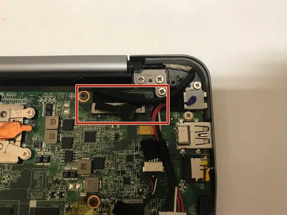

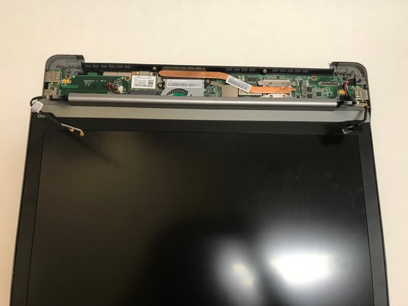

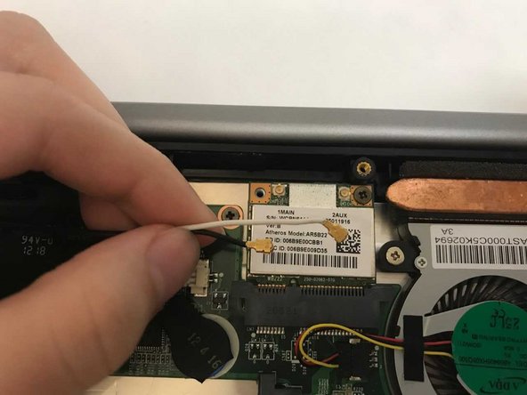

  4. Vizio CT15 Display Replacement, Display: crwdns2935265:04crwdnd2935265:01crwdnd2935265:03crwdne2935265:0 Vizio CT15 Display Replacement, Display: crwdns2935265:04crwdnd2935265:02crwdnd2935265:03crwdne2935265:0 Vizio CT15 Display Replacement, Display: crwdns2935265:04crwdnd2935265:03crwdnd2935265:03crwdne2935265:0
    • Using your fingers, unplug the wires.
  5. Vizio CT15 Display Replacement: crwdns2935265:05crwdnd2935265:01crwdnd2935265:02crwdne2935265:0 Vizio CT15 Display Replacement: crwdns2935265:05crwdnd2935265:02crwdnd2935265:02crwdne2935265:0
    • Remove the six Phillips #0 screws.
    • Disconnect the display from the laptop base by pulling the two apart from each other.
