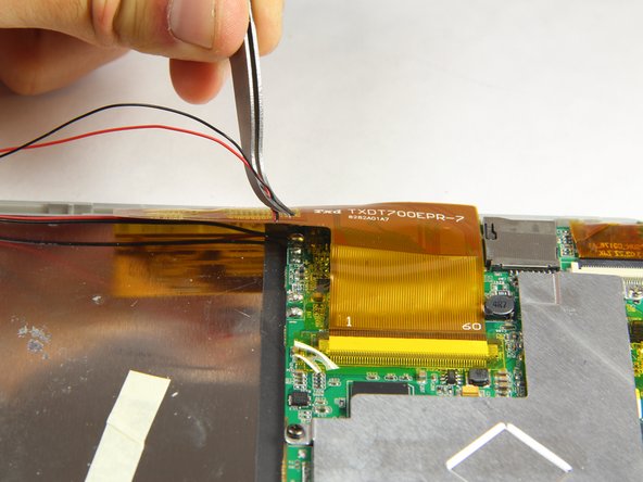

  8. Vivitar XO 7 Speaker Replacement: crwdns2935265:08crwdnd2935265:01crwdnd2935265:02crwdne2935265:0 Vivitar XO 7 Speaker Replacement: crwdns2935265:08crwdnd2935265:02crwdnd2935265:02crwdne2935265:0
    • With tweezers, firmly grab the wire at the base and pull to disconnect the speaker from the motherboard.
