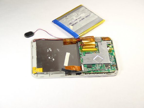

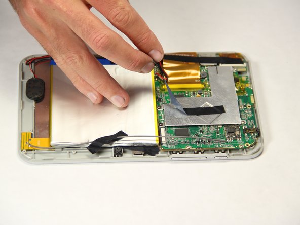

    1. Vivitar XO 7 Camera Replacement, Battery: crwdns2935265:04crwdnd2935265:01crwdnd2935265:02crwdne2935265:0 Vivitar XO 7 Camera Replacement, Battery: crwdns2935265:04crwdnd2935265:02crwdnd2935265:02crwdne2935265:0
      • Peel off the black pieces of tape from the internal components.
    2. Vivitar XO 7 Camera Replacement: crwdns2935265:05crwdnd2935265:01crwdnd2935265:02crwdne2935265:0 Vivitar XO 7 Camera Replacement: crwdns2935265:05crwdnd2935265:02crwdnd2935265:02crwdne2935265:0
      • Carefully remove the battery from the tablet.

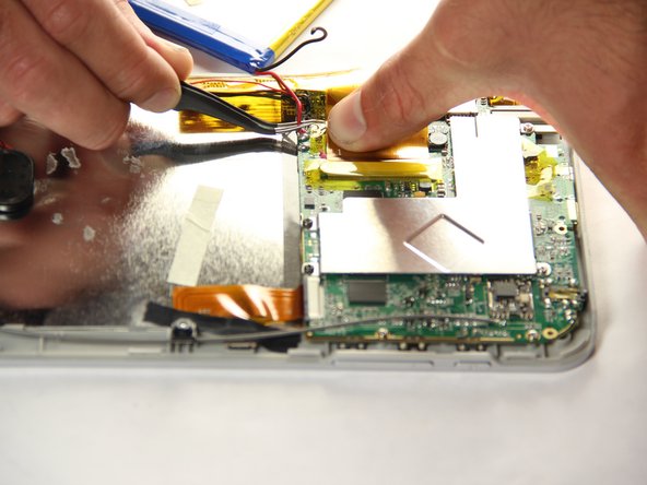

    3. Vivitar XO 7 Camera Replacement: crwdns2935265:06crwdnd2935265:01crwdnd2935265:02crwdne2935265:0 Vivitar XO 7 Camera Replacement: crwdns2935265:06crwdnd2935265:02crwdnd2935265:02crwdne2935265:0
      • With the tweezers, firmly grab the wire at the base and pull to disconnect the battery from the motherboard.

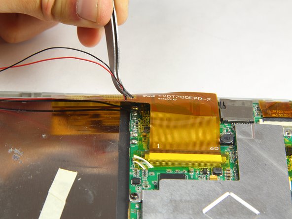

    1. Vivitar XO 7 Camera Replacement, Camera: crwdns2935265:07crwdnd2935265:01crwdnd2935265:01crwdne2935265:0
      • Peel off black tape that is holding the camera in place.
    2. Vivitar XO 7 Camera Replacement: crwdns2935265:08crwdnd2935265:01crwdnd2935265:01crwdne2935265:0
      • Carefully disconnect the ribbon cables from the motherboard.
    3. Vivitar XO 7 Camera Replacement: crwdns2935265:09crwdnd2935265:01crwdnd2935265:02crwdne2935265:0 Vivitar XO 7 Camera Replacement: crwdns2935265:09crwdnd2935265:02crwdnd2935265:02crwdne2935265:0
      • Using the tweezers, firmly grab wires and pull to disconnect them from the motherboard.
