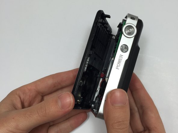

  3. Vivitar Vivicam T027 Screen Replacement: crwdns2935265:03crwdnd2935265:01crwdnd2935265:02crwdne2935265:0 Vivitar Vivicam T027 Screen Replacement: crwdns2935265:03crwdnd2935265:02crwdnd2935265:02crwdne2935265:0
    • Separate the front piece of the camera from the back to reveal the motherboard.

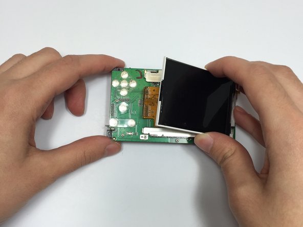

  6. Vivitar Vivicam T027 Screen Replacement: crwdns2935265:06crwdnd2935265:01crwdnd2935265:01crwdne2935265:0
    • Remove the black plastic cover to reveal the newly exposed screen.
  7. Vivitar Vivicam T027 Screen Replacement: crwdns2935265:07crwdnd2935265:01crwdnd2935265:02crwdne2935265:0 Vivitar Vivicam T027 Screen Replacement: crwdns2935265:07crwdnd2935265:02crwdnd2935265:02crwdne2935265:0
    • Carefully remove the gold film from the screen with a plastic opening tool.
    • Gently pull the screen off the camera.
