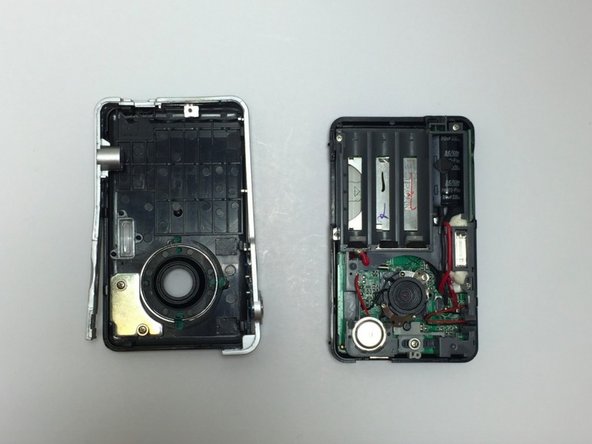

  3. Vivitar Vivicam T027 Power Button Replacement: crwdns2935265:03crwdnd2935265:01crwdnd2935265:02crwdne2935265:0 Vivitar Vivicam T027 Power Button Replacement: crwdns2935265:03crwdnd2935265:02crwdnd2935265:02crwdne2935265:0
    • Separate the front and the back of the camera completely to expose the motherboard.

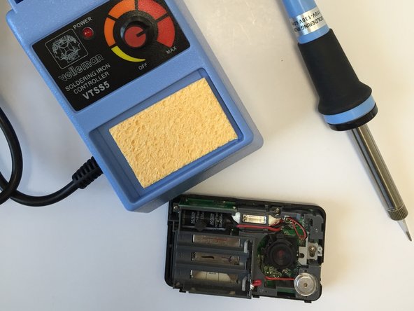

  5. Vivitar Vivicam T027 Power Button Replacement: crwdns2935265:05crwdnd2935265:01crwdnd2935265:02crwdne2935265:0 Vivitar Vivicam T027 Power Button Replacement: crwdns2935265:05crwdnd2935265:02crwdnd2935265:02crwdne2935265:0
    • Using a soldering kit, de-solder the black and red wire from the silver power button.
    • Solder the new power button to the black and red wire.
    • To avoid burns, be careful of the heat from the soldering iron.
    • Reference the soldering guide for assistance!
