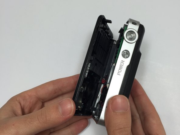

  3. Vivitar Vivicam T027 Lens Replacement: crwdns2935265:03crwdnd2935265:01crwdnd2935265:02crwdne2935265:0 Vivitar Vivicam T027 Lens Replacement: crwdns2935265:03crwdnd2935265:02crwdnd2935265:02crwdne2935265:0
    • Separate the front piece of the camera from the back, revealing the motherboard.

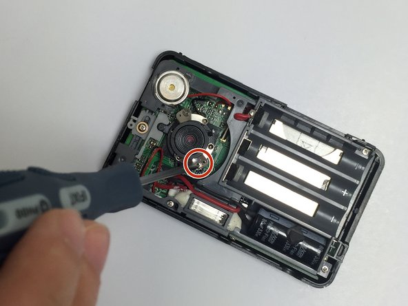

  4. Vivitar Vivicam T027 Lens Replacement: crwdns2935265:04crwdnd2935265:01crwdnd2935265:02crwdne2935265:0 Vivitar Vivicam T027 Lens Replacement: crwdns2935265:04crwdnd2935265:02crwdnd2935265:02crwdne2935265:0
    • Use a Phillips #000 screwdriver to remove the two 2.3 mm screws that surround the lens.

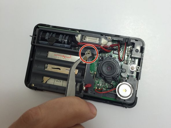

  5. Vivitar Vivicam T027 Lens Replacement: crwdns2935265:05crwdnd2935265:01crwdnd2935265:02crwdne2935265:0 Vivitar Vivicam T027 Lens Replacement: crwdns2935265:05crwdnd2935265:02crwdnd2935265:02crwdne2935265:0
    • Remove the two silver plates using tweezers.
