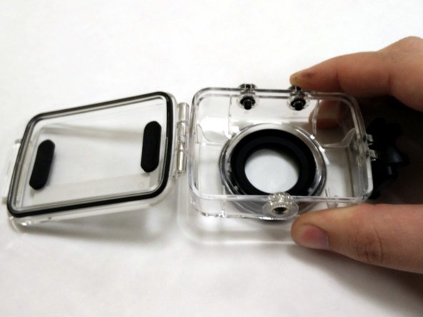

    • Place waterproof case on flat surface, with the lens cover facing up.
  2. Vivitar DVR 781HD Waterproof Case Lens Cover Replacement: crwdns2935265:02crwdnd2935265:01crwdnd2935265:02crwdne2935265:0 Vivitar DVR 781HD Waterproof Case Lens Cover Replacement: crwdns2935265:02crwdnd2935265:02crwdnd2935265:02crwdne2935265:0
    • Remove the six 4.5mm Phillips #00 screws from the black lens cover trim.

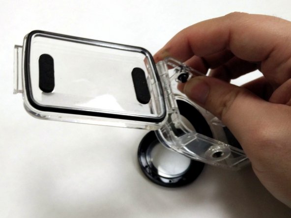

    • Apply pressure to the lens cover with your thumb, and use your other fingers to pull up on the case, separating the lens and lens trim from the case.
  5. Vivitar DVR 781HD Waterproof Case Lens Cover Replacement: crwdns2935265:05crwdnd2935265:01crwdnd2935265:02crwdne2935265:0 Vivitar DVR 781HD Waterproof Case Lens Cover Replacement: crwdns2935265:05crwdnd2935265:02crwdnd2935265:02crwdne2935265:0

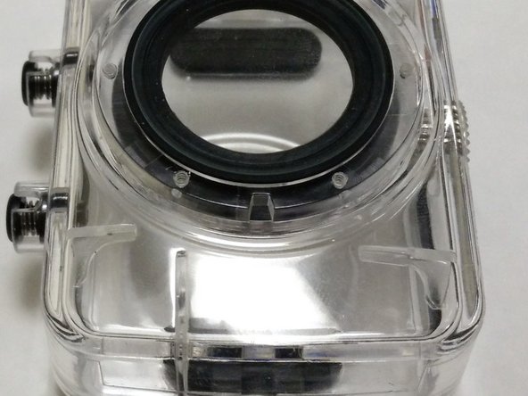

    • There is a small plastic key on the black bezel that aligns it to the case. Be sure to line this up during reassembly.
