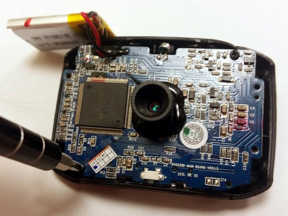

      • Move the plastic opening tool around the seam and apply force at each step to separate the front plate from the back plate and motherboard.
      • The battery is held to the front half of the case with double-sided tape. Peel it up with a finger, being careful not to damage the battery.

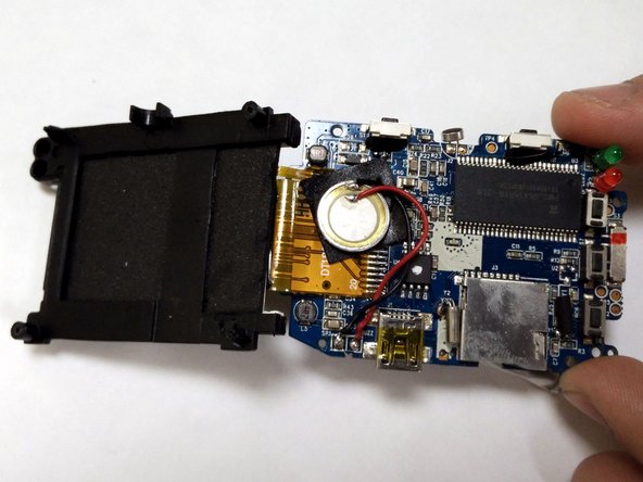

    1. Vivitar DVR 781HD Screen Replacement, Motherboard: crwdns2935265:04crwdnd2935265:01crwdnd2935265:02crwdne2935265:0 Vivitar DVR 781HD Screen Replacement, Motherboard: crwdns2935265:04crwdnd2935265:02crwdnd2935265:02crwdne2935265:0
      • Using a P1 screwdriver, remove the 4mm screws holding the motherboard into the case.
    2. Vivitar DVR 781HD Screen Replacement: crwdns2935265:05crwdnd2935265:01crwdnd2935265:01crwdne2935265:0
      • Gently lift the motherboard, handling it by the edges.
    1. Vivitar DVR 781HD Screen Replacement, Screen: crwdns2935265:06crwdnd2935265:01crwdnd2935265:02crwdne2935265:0 Vivitar DVR 781HD Screen Replacement, Screen: crwdns2935265:06crwdnd2935265:02crwdnd2935265:02crwdne2935265:0
      • Remove the two 4mm Phillips #1 screws holding the screen assembly to the motherboard.
    2. Vivitar DVR 781HD Screen Replacement: crwdns2935265:07crwdnd2935265:01crwdnd2935265:02crwdne2935265:0 Vivitar DVR 781HD Screen Replacement: crwdns2935265:07crwdnd2935265:02crwdnd2935265:02crwdne2935265:0
      • Turn the motherboard and screen over.
      • Gently lift the screen from the motherboard, handling it by the edges of the black plastic holder.
    3. Vivitar DVR 781HD Screen Replacement: crwdns2935265:08crwdnd2935265:01crwdnd2935265:01crwdne2935265:0
      • Using a soldering iron, melt the solder connection between the screen's ribbon cable and the motherboard. Pull the ribbon cable away before the solder solidifies.
