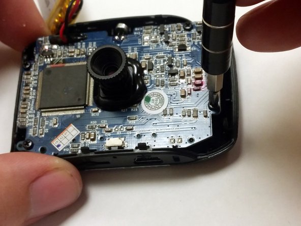

    • Begin with the camcorder lens up on a clear working surface.
    • Remove the two 4mm Phillips #1 screws holding the switch plate in place. Rotate the device 180 degrees and repeat for the screws on the opposite side.
  2. Vivitar DVR 781HD Motherboard Replacement: crwdns2935265:02crwdnd2935265:01crwdnd2935265:01crwdne2935265:0
    • Slide the plastic opening tool into the seam between the front and back sections of the case and apply a small amount of force to pop the case open.
  3. Vivitar DVR 781HD Motherboard Replacement: crwdns2935265:03crwdnd2935265:01crwdnd2935265:03crwdne2935265:0 Vivitar DVR 781HD Motherboard Replacement: crwdns2935265:03crwdnd2935265:02crwdnd2935265:03crwdne2935265:0 Vivitar DVR 781HD Motherboard Replacement: crwdns2935265:03crwdnd2935265:03crwdnd2935265:03crwdne2935265:0
    • Move the plastic opening tool around the seam and apply force at each step to separate the front plate from the back plate and motherboard.
    • The battery is held to the front half of the case with double-sided tape. Peel it up with a finger, being careful not to damage the battery.
  4. Vivitar DVR 781HD Motherboard Replacement, Motherboard: crwdns2935265:04crwdnd2935265:01crwdnd2935265:02crwdne2935265:0 Vivitar DVR 781HD Motherboard Replacement, Motherboard: crwdns2935265:04crwdnd2935265:02crwdnd2935265:02crwdne2935265:0
    • Using a P1 screwdriver, remove the 4mm screws holding the motherboard into the case.
  5. Vivitar DVR 781HD Motherboard Replacement: crwdns2935265:05crwdnd2935265:01crwdnd2935265:01crwdne2935265:0
    • Gently lift the motherboard, handling it by the edges.
