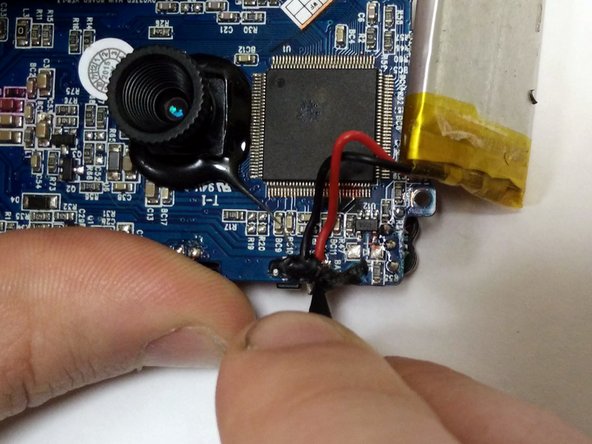

    1. Vivitar DVR 781HD Battery Replacement, Battery: crwdns2935265:06crwdnd2935265:01crwdnd2935265:02crwdne2935265:0 Vivitar DVR 781HD Battery Replacement, Battery: crwdns2935265:06crwdnd2935265:02crwdnd2935265:02crwdne2935265:0
      • The battery connections are reinforced by black potting compound. Gently pry it away with a plastic spudger.
      • Be very careful with this step, as applying too much force can damage the motherboard or the components on it.
    2. Vivitar DVR 781HD Battery Replacement: crwdns2935265:07crwdnd2935265:01crwdnd2935265:01crwdne2935265:0
      • Melt the soldered battery connections with a soldering iron and gently pull the battery wires away.

Any 3.7v Lithium Ion cell will work, truth be told, but if you google the writing you find on the factory battery once you open it, you will likely find dozens of vendors on ebay, amazon, alibaba, wish, etc. personally, i removed the battery and ran leads from the factory battery wires to an external battery pack that holds an 18650 cell which significantly increased available maH
