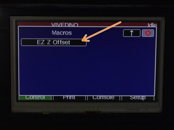

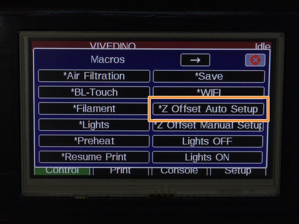

  1. Vivedino Troodon Screens and Macros, EZ Z Offset: crwdns2935265:01crwdnd2935265:01crwdnd2935265:03crwdne2935265:0 Vivedino Troodon Screens and Macros, EZ Z Offset: crwdns2935265:01crwdnd2935265:02crwdnd2935265:03crwdne2935265:0 Vivedino Troodon Screens and Macros, EZ Z Offset: crwdns2935265:01crwdnd2935265:03crwdnd2935265:03crwdne2935265:0
    • Macro> Z Offset Auto Setup> EZ Z Offset. Follow the prompts and afterwards, your Z Offset will be dialed in and stored.

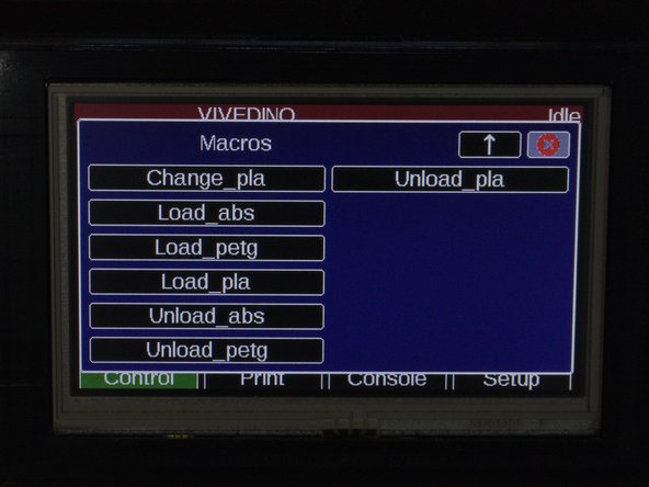

  2. Vivedino Troodon Screens and Macros: crwdns2935265:02crwdnd2935265:01crwdnd2935265:02crwdne2935265:0 Vivedino Troodon Screens and Macros: crwdns2935265:02crwdnd2935265:02crwdnd2935265:02crwdne2935265:0
    • Macros for different filaments. The temperature changes for each.
