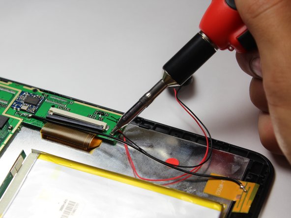

    • Soldering guns are hot and can easily damage the device.
    • Desolder the two connection points at the black and red wires.
    • A helpful guide for desoldering can be found here How To Solder and Desolder Connections.
