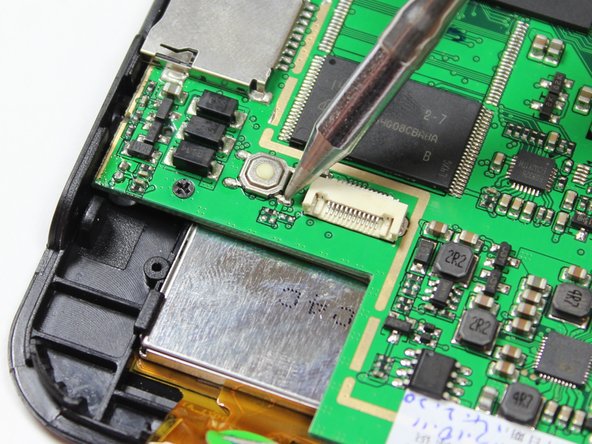

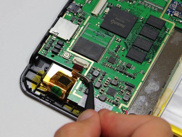

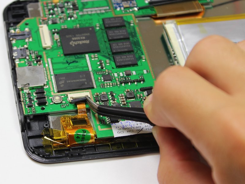

    1. Visual Land Prestige Pro 7D Reset Button Replacement, Reset Button: crwdns2935265:03crwdnd2935265:01crwdnd2935265:02crwdne2935265:0 Visual Land Prestige Pro 7D Reset Button Replacement, Reset Button: crwdns2935265:03crwdnd2935265:02crwdnd2935265:02crwdne2935265:0
      • Use the tweezers to lift the grey connector, located next to the reset button, up from the beige housing. It should rotate up, and allow you to slide the ribbon out from under the connector.
      • Although not necessary for replacing the reset button, it is highly recommended to disconnect the ribbon. This ensures it will not get damaged during desoldering.

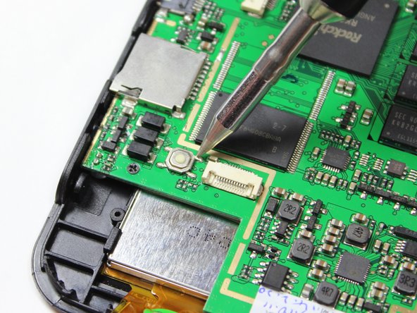

    2. Visual Land Prestige Pro 7D Reset Button Replacement: crwdns2935265:04crwdnd2935265:01crwdnd2935265:03crwdne2935265:0 Visual Land Prestige Pro 7D Reset Button Replacement: crwdns2935265:04crwdnd2935265:02crwdnd2935265:03crwdne2935265:0 Visual Land Prestige Pro 7D Reset Button Replacement: crwdns2935265:04crwdnd2935265:03crwdnd2935265:03crwdne2935265:0
      • Soldering guns are hot and can easily damage the device.
      • Desolder the four side dots holding the reset button in place.
      • If this is your first time desoldering, here is a helpful guide to show you How To Solder and Desolder Connections.
