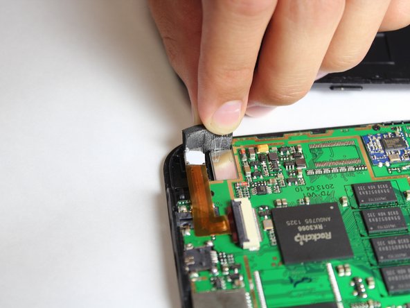

    1. Visual Land Prestige Pro 7D Camera Replacement, Front-Facing Camera: crwdns2935265:03crwdnd2935265:01crwdnd2935265:02crwdne2935265:0 Visual Land Prestige Pro 7D Camera Replacement, Front-Facing Camera: crwdns2935265:03crwdnd2935265:02crwdnd2935265:02crwdne2935265:0
      • Remove the black pad on the back of the camera by peeling it off.
    2. Visual Land Prestige Pro 7D Camera Replacement: crwdns2935265:04crwdnd2935265:01crwdnd2935265:01crwdne2935265:0
      • With the bottom of the device facing away from you, pull the camera out of its black housing.
      • The camera will come right out when you lift with your fingers.
    3. Visual Land Prestige Pro 7D Camera Replacement: crwdns2935265:05crwdnd2935265:01crwdnd2935265:01crwdne2935265:0
      • Use the tweezers to lift the grey connector, connecting the camera ribbon to the circuit board, up from the beige housing. It should rotate up, and allow you to slide the ribbon out from under the connector.
