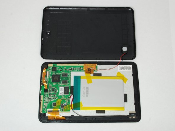

    • Once all connections have been loosened and using a soft surface, place the device onto its screen.
    • Open the casing and lay as shown in the picture keeping the speaker wires loose.

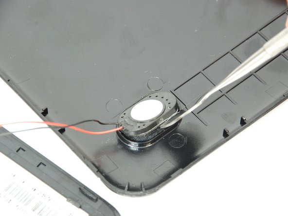

    • Using ESD safe tweezers and a spudger, gently remove the glued speaker away from the casing.
    • The speaker is still connected to the motherboard with wire.

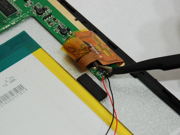

    • Before replacing the speaker, it's helpful to disconnect the LCD ribbon allowing sufficient space.
    • Remove the tape, and using hook tweezers, disconnect the LCD ZIF (zero insertion force) connection.
    • The ZIF connection takes manuvering, but the ribbon should be free and pushed out of the way.

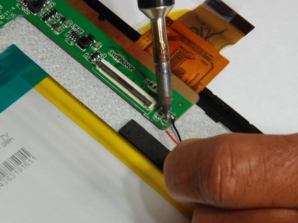

    • Before disconnecting the speaker, refer to Soldering Tips for proper soldering instructions.
    • Check the connection between the speaker and the motherboard. If it isn’t connected well, re-soldering the joint may fix the speaker.
    • Use a soldering iron the remove the speaker wires.
    • Ensure that each wire and solder connection do not touch. This will damage the device.
    • Note which nodes the wires are connected to, for replacement will occur in this order.
