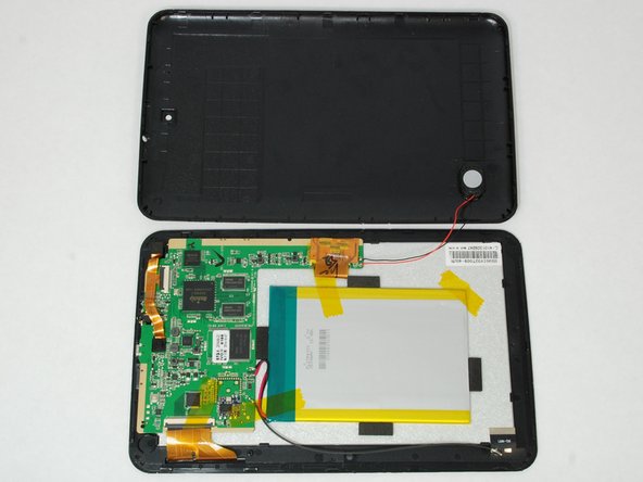

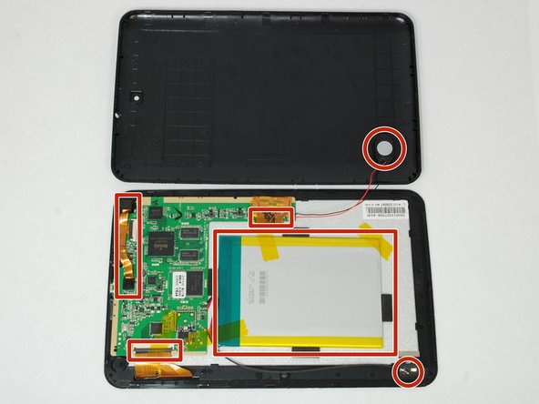

    • Once all connections have been loosened and using a soft surface, place the device onto its screen and lift gently on the outer casing.
    • Open the casing and lay as shown keeping the speaker wires loose.
    • The highlighted areas represent connections to disassemble.

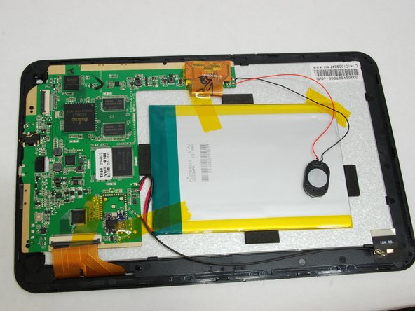

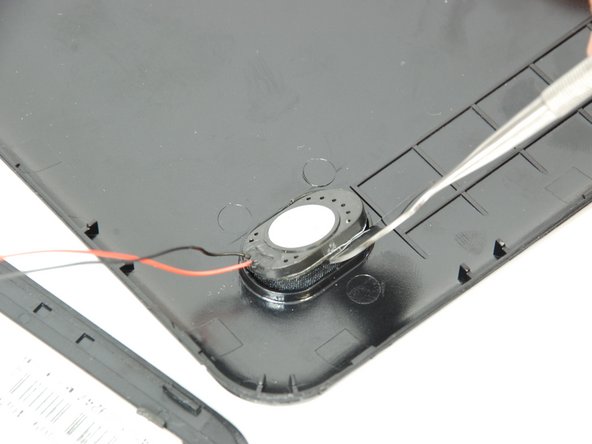

    • Using hook tweezers and a spudger, gently remove the glued speaker away from the casing.
    • The tweezers can damage the speaker.
    • The speaker is still connected to the motherboard with wire, so be cautious during this process.

    • Using wide-tip tweezers, gently remove the three pieces of tape attached to battery
    • The battery is still connected to the circuit board, and do not damage the tape as it holds the battery to the rest of the device.

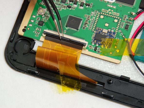

    • Gently remove tape from circuit board, and disconnect the ZIF (zero insertion force) connectors for the front panel and LCD screen.
    • Use tweezers to lift up the black hinged lock on top of the ZIF connector.

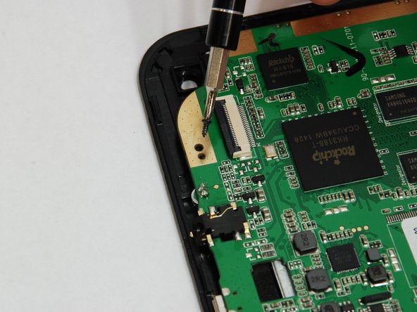

    • These are the three screws holding the circuit board.
    • Use J00 or PH00 to remove the three screws.
