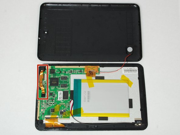

    • Once all connections have been loosened and using a soft surface, place the device onto its screen.
    • Open the casing and lay as shown keeping the speaker wire loose, and the camera component is highlighted in red.

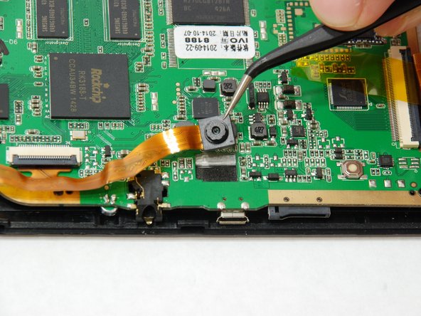

    • Using hook tweezers, gently separate the glued cameras away from the circuit board.
    • Allow each camera to rest on circuit board while proceeding to the ZIF (zero insertion force) on the circuit board.
    • Avoid touching camera lens with the tweezers.

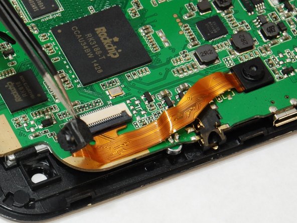

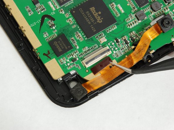

  5. Visual Land Prestige Elite 9Q Front and Rear Facing Camera Replacement: crwdns2935265:05crwdnd2935265:01crwdnd2935265:02crwdne2935265:0 Visual Land Prestige Elite 9Q Front and Rear Facing Camera Replacement: crwdns2935265:05crwdnd2935265:02crwdnd2935265:02crwdne2935265:0
    • Maneuver the hook tweezers to flip up the black hinged ZIF connector to disconnect camera module.
    • After ZIF connector is flipped up, the camera module may be removed.
