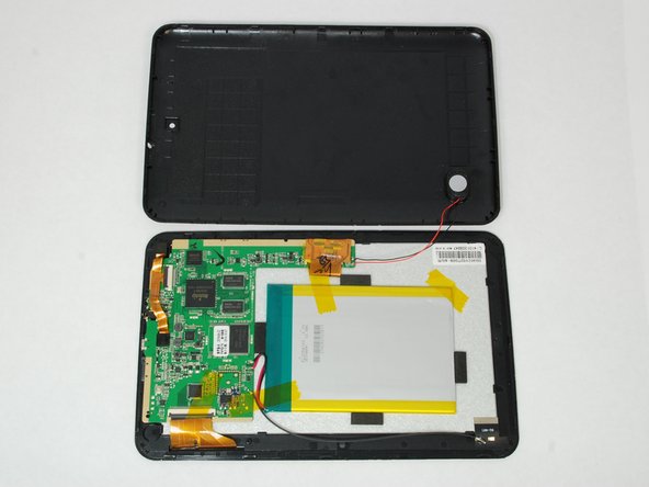

    • Once all connections have been loosened and using a soft surface, place the device onto its screen, and lift gently on the outer casing.
    • Open the casing and lay as shown keeping the speaker wires loose.

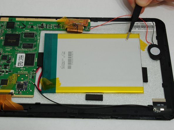

    • Use wide tip tweezers to gently remove the three pieces of tape attached to battery.
    • Once the tape has been removed, the battery will be free from the tablet except for the wired connections to the circuit board.
    • Be careful not to severely damage the tape as this is what will hold the battery in place.
    • Mark where the positive (red) and negative (black) wires are on the circuit board.
    • Markings will be used for reassembly.

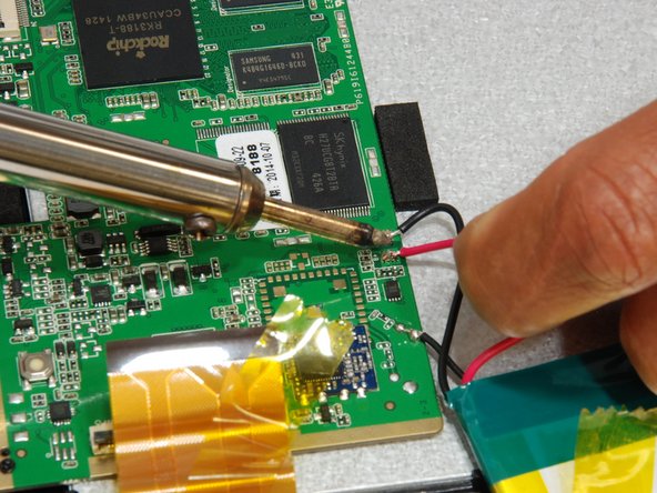

    • Before disconnecting battery, review Soldering Tips to ensure proper soldering.
    • Use soldering iron to remove +(red) battery lead.
    • Touch the positive wire to a metal surface acting as a ground to discharge the battery. Depending on the charge level of the battery, it may take up to 30 seconds to insure that it is fully discharged.
    • 'Ensure that the wires and solder do not touch each other, for this will damage the device
    • Remove the -(black) battery lead.
    • Remove and discard the old battery. Insert new battery and solder the positive and then the negative terminals to the circuit board.
