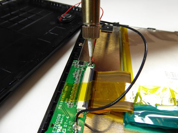

    • Soldering iron may be dangerous for inexperienced users. For additional information on how to use a soldering iron, click here.
    • Use a soldering iron to detach the speaker wires from the motherboard.

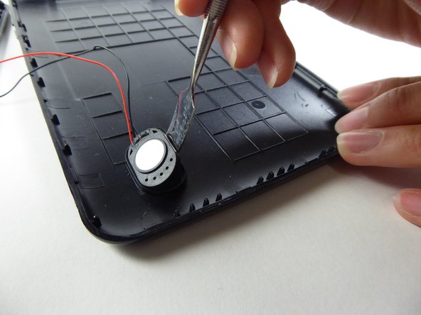

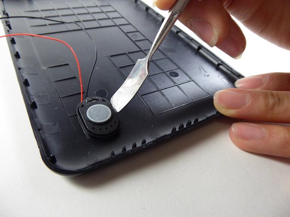

    • Use a curved metal spudger to remove the speaker from the back case.
    • The speaker is held in place by an adhesive and can be difficult to remove.
