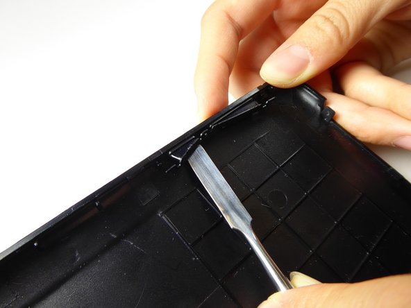

    • At the bottom of the tablet, remove the two 3.6mm screws with a Phillips #000 screwdriver.
  2. Visual Land Prestige Elite 7Q Side Buttons Replacement: crwdns2935265:02crwdnd2935265:01crwdnd2935265:02crwdne2935265:0 Visual Land Prestige Elite 7Q Side Buttons Replacement: crwdns2935265:02crwdnd2935265:02crwdnd2935265:02crwdne2935265:0
    • Wedge a plastic opening tool into the edges of the tablet to pry it open.

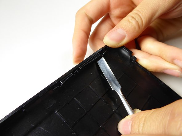

  3. Visual Land Prestige Elite 7Q Side Buttons Replacement: crwdns2935265:03crwdnd2935265:01crwdnd2935265:03crwdne2935265:0 Visual Land Prestige Elite 7Q Side Buttons Replacement: crwdns2935265:03crwdnd2935265:02crwdnd2935265:03crwdne2935265:0 Visual Land Prestige Elite 7Q Side Buttons Replacement: crwdns2935265:03crwdnd2935265:03crwdnd2935265:03crwdne2935265:0
    • Using a metal spudger and/or your fingers, press the power button in and lift the outside tab.

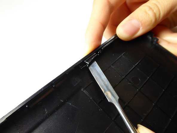

  4. Visual Land Prestige Elite 7Q Side Buttons Replacement: crwdns2935265:04crwdnd2935265:01crwdnd2935265:02crwdne2935265:0 Visual Land Prestige Elite 7Q Side Buttons Replacement: crwdns2935265:04crwdnd2935265:02crwdnd2935265:02crwdne2935265:0
    • Using a metal spudger and/or your fingers, press the volume button in and lift the outside tab.

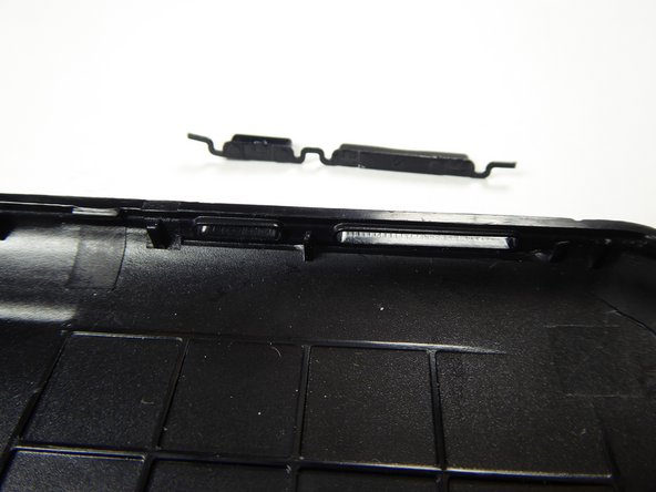

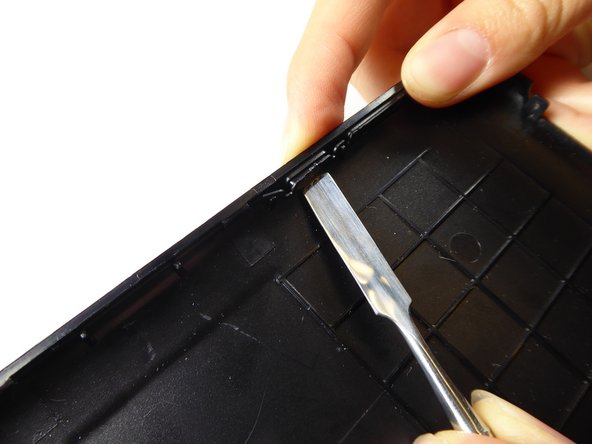

  5. Visual Land Prestige Elite 7Q Side Buttons Replacement: crwdns2935265:05crwdnd2935265:01crwdnd2935265:03crwdne2935265:0 Visual Land Prestige Elite 7Q Side Buttons Replacement: crwdns2935265:05crwdnd2935265:02crwdnd2935265:03crwdne2935265:0 Visual Land Prestige Elite 7Q Side Buttons Replacement: crwdns2935265:05crwdnd2935265:03crwdnd2935265:03crwdne2935265:0
    • Using the metal spudger, dislodge and lift the power and volume buttons
