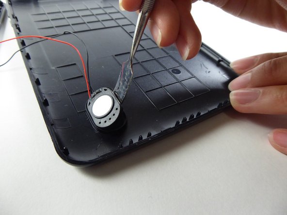

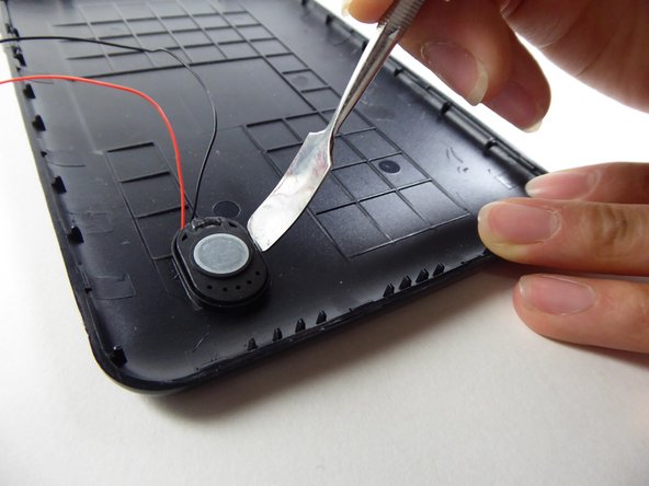

  3. Visual Land Prestige Elite 7Q LCD Screen Replacement: crwdns2935265:03crwdnd2935265:01crwdnd2935265:03crwdne2935265:0 Visual Land Prestige Elite 7Q LCD Screen Replacement: crwdns2935265:03crwdnd2935265:02crwdnd2935265:03crwdne2935265:0 Visual Land Prestige Elite 7Q LCD Screen Replacement: crwdns2935265:03crwdnd2935265:03crwdnd2935265:03crwdne2935265:0
    • Wedge a curved metal spudger to remove the speaker.

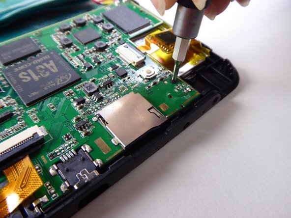

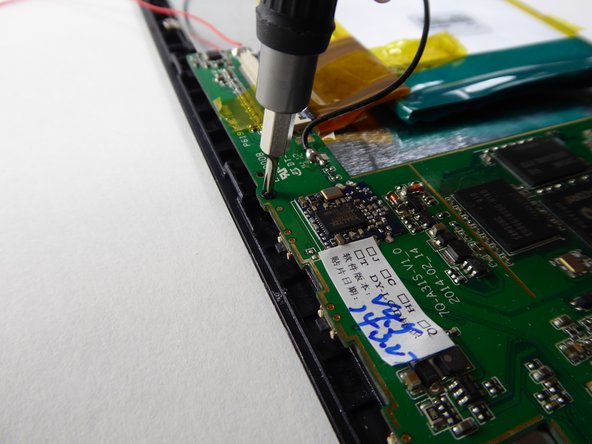

  4. Visual Land Prestige Elite 7Q LCD Screen Replacement: crwdns2935265:04crwdnd2935265:01crwdnd2935265:03crwdne2935265:0 Visual Land Prestige Elite 7Q LCD Screen Replacement: crwdns2935265:04crwdnd2935265:02crwdnd2935265:03crwdne2935265:0 Visual Land Prestige Elite 7Q LCD Screen Replacement: crwdns2935265:04crwdnd2935265:03crwdnd2935265:03crwdne2935265:0
    • Use a Phillips #000 screwdriver to remove the two 3.6mm screws.

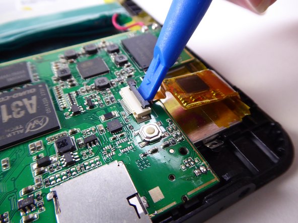

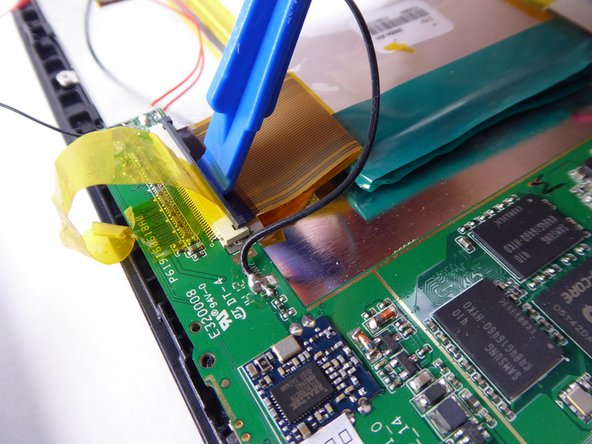

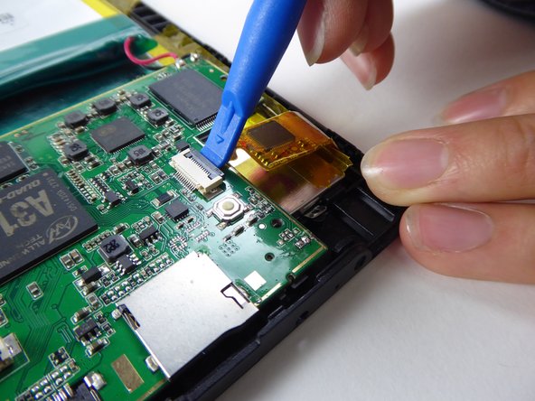

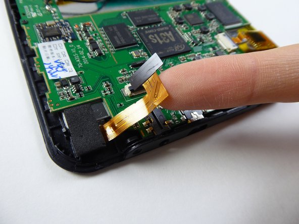

  5. Visual Land Prestige Elite 7Q LCD Screen Replacement: crwdns2935265:05crwdnd2935265:01crwdnd2935265:03crwdne2935265:0 Visual Land Prestige Elite 7Q LCD Screen Replacement: crwdns2935265:05crwdnd2935265:02crwdnd2935265:03crwdne2935265:0 Visual Land Prestige Elite 7Q LCD Screen Replacement: crwdns2935265:05crwdnd2935265:03crwdnd2935265:03crwdne2935265:0

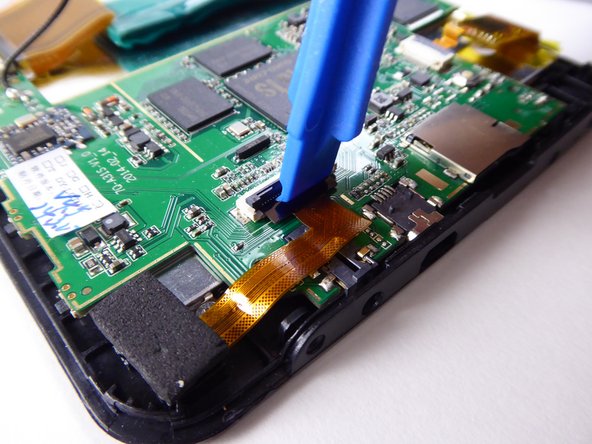

    • Use a plastic opening tool to lift the black tab.
  6. Visual Land Prestige Elite 7Q LCD Screen Replacement: crwdns2935265:06crwdnd2935265:01crwdnd2935265:02crwdne2935265:0 Visual Land Prestige Elite 7Q LCD Screen Replacement: crwdns2935265:06crwdnd2935265:02crwdnd2935265:02crwdne2935265:0
    • Carefully remove the ribbon cable from the black tab.
  7. Visual Land Prestige Elite 7Q LCD Screen Replacement: crwdns2935265:07crwdnd2935265:01crwdnd2935265:02crwdne2935265:0 Visual Land Prestige Elite 7Q LCD Screen Replacement: crwdns2935265:07crwdnd2935265:02crwdnd2935265:02crwdne2935265:0

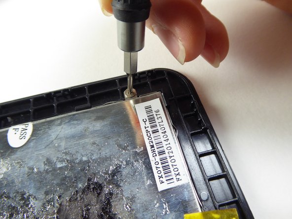

  8. Visual Land Prestige Elite 7Q LCD Screen Replacement: crwdns2935265:08crwdnd2935265:01crwdnd2935265:02crwdne2935265:0 Visual Land Prestige Elite 7Q LCD Screen Replacement: crwdns2935265:08crwdnd2935265:02crwdnd2935265:02crwdne2935265:0
    • Use a Phillips #000 screwdriver to remove the 3.6mm screw.

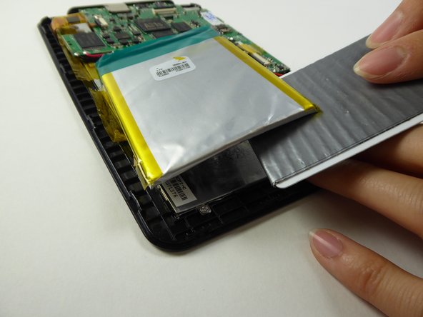

  9. Visual Land Prestige Elite 7Q LCD Screen Replacement: crwdns2935265:09crwdnd2935265:01crwdnd2935265:03crwdne2935265:0 Visual Land Prestige Elite 7Q LCD Screen Replacement: crwdns2935265:09crwdnd2935265:02crwdnd2935265:03crwdne2935265:0 Visual Land Prestige Elite 7Q LCD Screen Replacement: crwdns2935265:09crwdnd2935265:03crwdnd2935265:03crwdne2935265:0
    • Lift the tape holding down the battery.

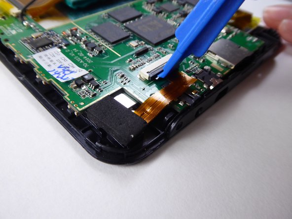

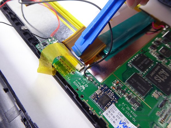

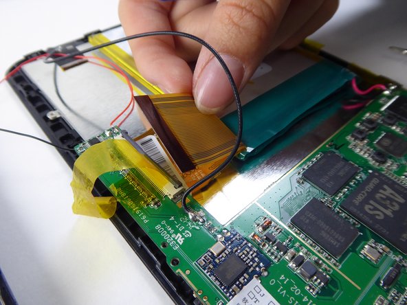

  11. Visual Land Prestige Elite 7Q LCD Screen Replacement: crwdns2935265:011crwdnd2935265:01crwdnd2935265:03crwdne2935265:0 Visual Land Prestige Elite 7Q LCD Screen Replacement: crwdns2935265:011crwdnd2935265:02crwdnd2935265:03crwdne2935265:0 Visual Land Prestige Elite 7Q LCD Screen Replacement: crwdns2935265:011crwdnd2935265:03crwdnd2935265:03crwdne2935265:0

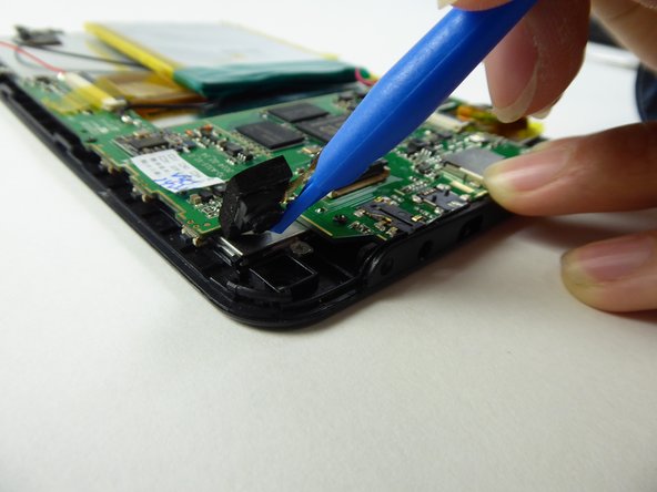

  12. Visual Land Prestige Elite 7Q LCD Screen Replacement: crwdns2935265:012crwdnd2935265:01crwdnd2935265:02crwdne2935265:0 Visual Land Prestige Elite 7Q LCD Screen Replacement: crwdns2935265:012crwdnd2935265:02crwdnd2935265:02crwdne2935265:0

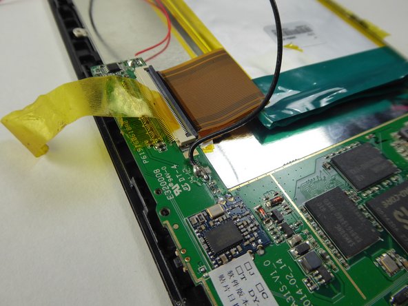

  13. Visual Land Prestige Elite 7Q LCD Screen Replacement: crwdns2935265:013crwdnd2935265:01crwdnd2935265:03crwdne2935265:0 Visual Land Prestige Elite 7Q LCD Screen Replacement: crwdns2935265:013crwdnd2935265:02crwdnd2935265:03crwdne2935265:0 Visual Land Prestige Elite 7Q LCD Screen Replacement: crwdns2935265:013crwdnd2935265:03crwdnd2935265:03crwdne2935265:0

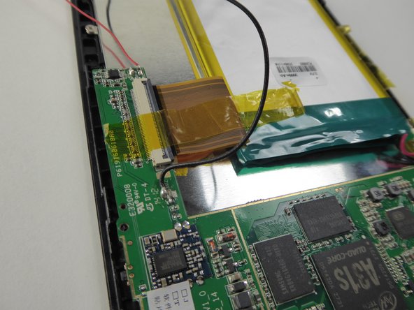

  14. Visual Land Prestige Elite 7Q LCD Screen Replacement: crwdns2935265:014crwdnd2935265:01crwdnd2935265:01crwdne2935265:0
    • Lift to remove the battery and motherboard from the tablet.

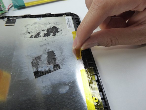

  15. Visual Land Prestige Elite 7Q LCD Screen Replacement: crwdns2935265:015crwdnd2935265:01crwdnd2935265:03crwdne2935265:0 Visual Land Prestige Elite 7Q LCD Screen Replacement: crwdns2935265:015crwdnd2935265:02crwdnd2935265:03crwdne2935265:0 Visual Land Prestige Elite 7Q LCD Screen Replacement: crwdns2935265:015crwdnd2935265:03crwdnd2935265:03crwdne2935265:0

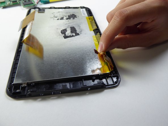

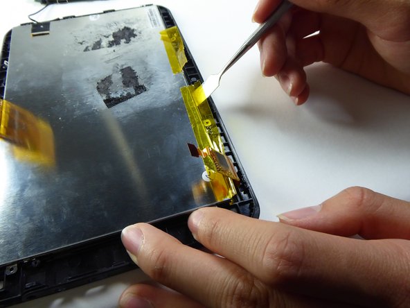

    • Lift the tape on the sides.

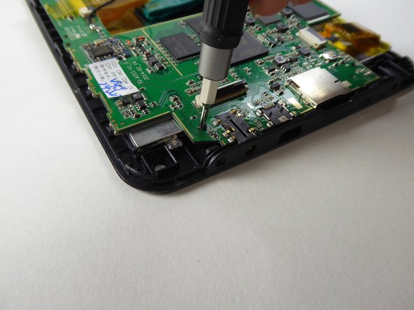

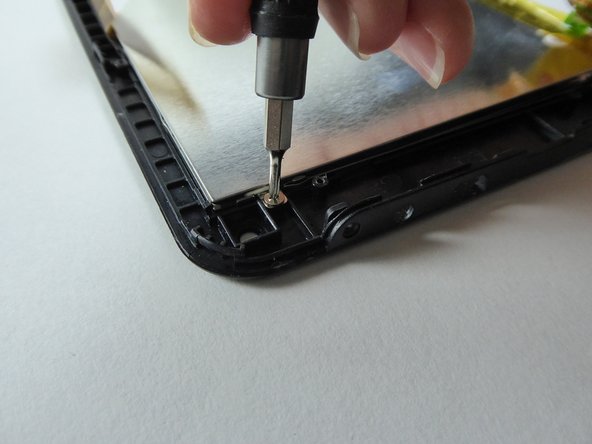

  16. Visual Land Prestige Elite 7Q LCD Screen Replacement: crwdns2935265:016crwdnd2935265:01crwdnd2935265:03crwdne2935265:0 Visual Land Prestige Elite 7Q LCD Screen Replacement: crwdns2935265:016crwdnd2935265:02crwdnd2935265:03crwdne2935265:0 Visual Land Prestige Elite 7Q LCD Screen Replacement: crwdns2935265:016crwdnd2935265:03crwdnd2935265:03crwdne2935265:0
    • Use a Phillips #000 screwdriver to remove the three 2.5mm screws.
  17. Visual Land Prestige Elite 7Q LCD Screen Replacement: crwdns2935265:017crwdnd2935265:01crwdnd2935265:03crwdne2935265:0 Visual Land Prestige Elite 7Q LCD Screen Replacement: crwdns2935265:017crwdnd2935265:02crwdnd2935265:03crwdne2935265:0 Visual Land Prestige Elite 7Q LCD Screen Replacement: crwdns2935265:017crwdnd2935265:03crwdnd2935265:03crwdne2935265:0

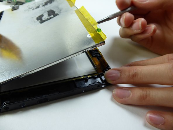

    • Be careful on this step - the screen is fragile and can break easily.
    • Wedge a metal spudger underneath the LCD to remove it.
    • Replace the LCD.
