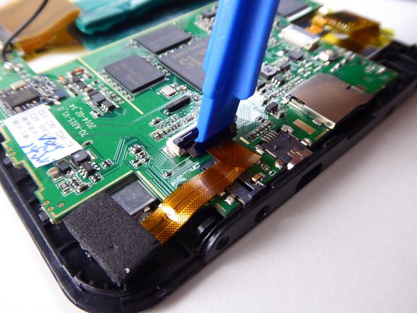

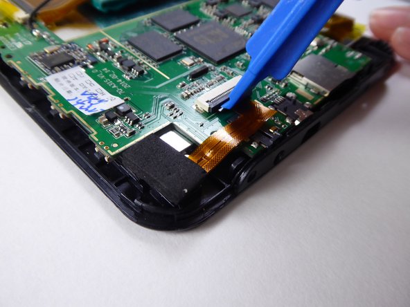

    • Use a plastic opening tool to lift the black tab holding down the ribbon cable.

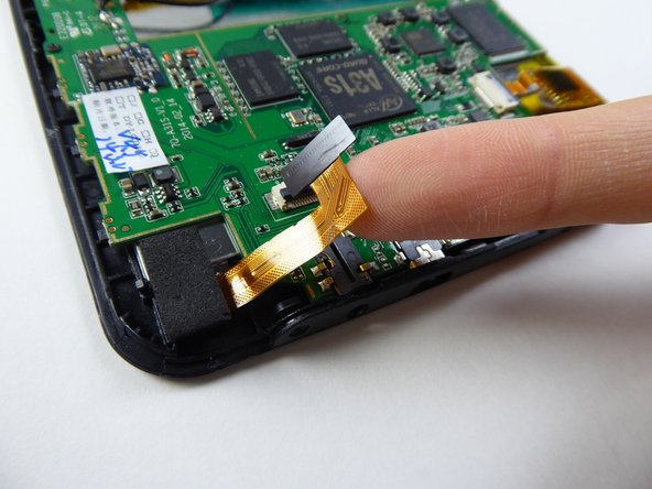

    • Carefully use your finger to pull out the ribbon cable.

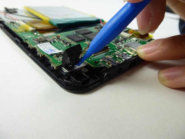

    • Use a plastic opening tool to pull out the camera with the foam backing.

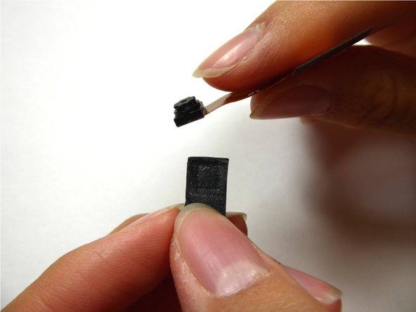

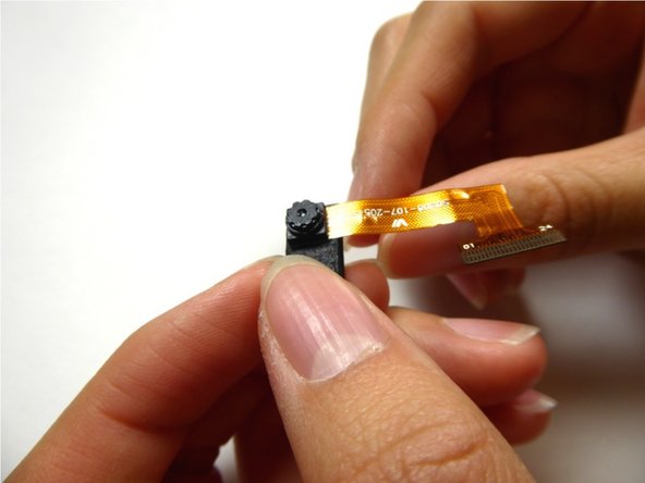

    • Remove the camera from the foam backing.
    • Replace the camera.
