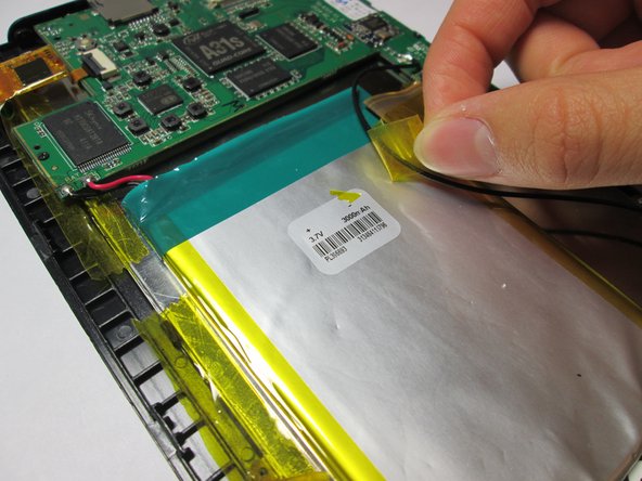

      • Peel off the yellow tape holding down the battery.

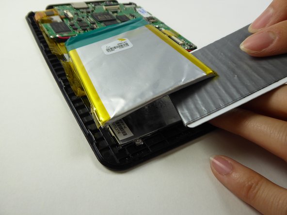

      • Use a plastic card to loosen the battery from the tablet. Note that it will be sticky underneath the battery.

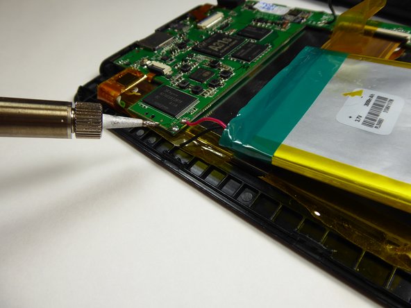

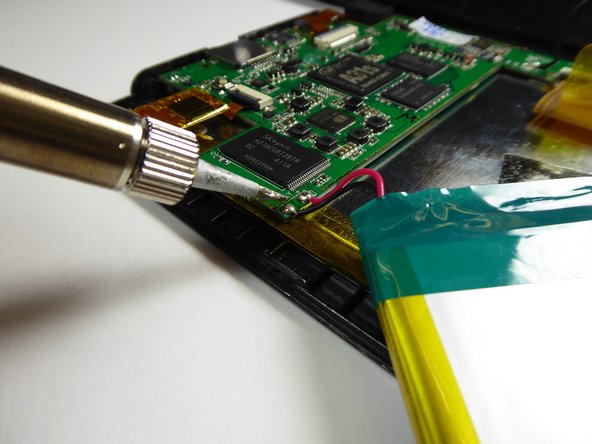

    5. Visual Land Prestige Elite 7Q Battery Replacement: crwdns2935265:05crwdnd2935265:01crwdnd2935265:03crwdne2935265:0 Visual Land Prestige Elite 7Q Battery Replacement: crwdns2935265:05crwdnd2935265:02crwdnd2935265:03crwdne2935265:0 Visual Land Prestige Elite 7Q Battery Replacement: crwdns2935265:05crwdnd2935265:03crwdnd2935265:03crwdne2935265:0
      • Soldering iron gets hot. For information on how to use a soldering iron, click here.
      • Use a soldering iron to detach the battery wires from the motherboard.
      • Replace the battery.
