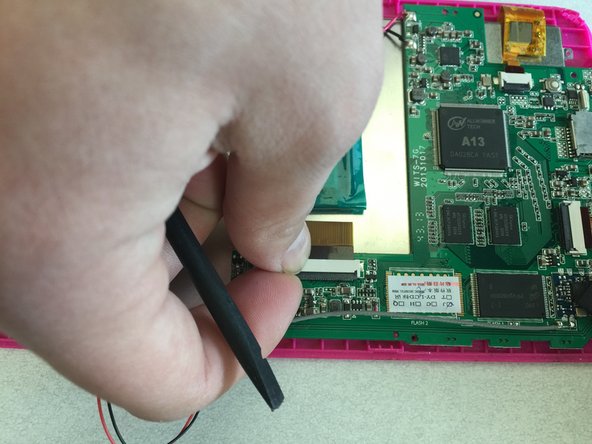

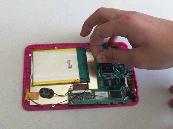

    • Remove the tape holding the motherboard, wires, and connecters in place.
  5. Visual Land Prestige 7L Screen Replacement: crwdns2935265:05crwdnd2935265:01crwdnd2935265:03crwdne2935265:0 Visual Land Prestige 7L Screen Replacement: crwdns2935265:05crwdnd2935265:02crwdnd2935265:03crwdne2935265:0 Visual Land Prestige 7L Screen Replacement: crwdns2935265:05crwdnd2935265:03crwdnd2935265:03crwdne2935265:0

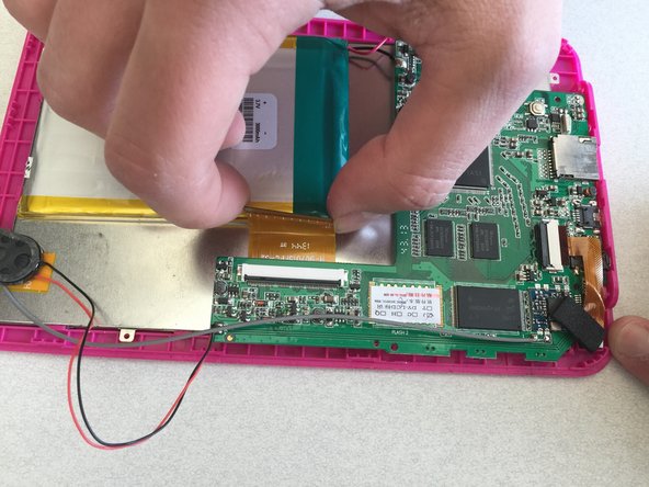

    • Unclip the three connectors by gently pulling the rear panel up and away from the motherboard.
    • For more information on unclipping connectors see this How To Guide
    • Pull out each of the gold connections.
    • The gold connections will disconnect from the motherboard, but not entirely from the device. Let them sit loosely where they are attached and be careful not to tear them when working in their proximity on the device.

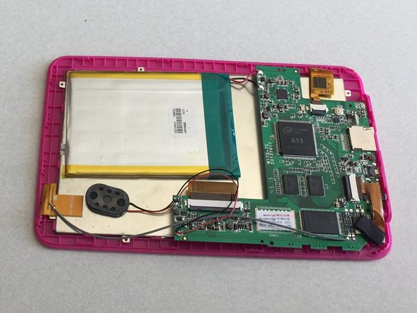

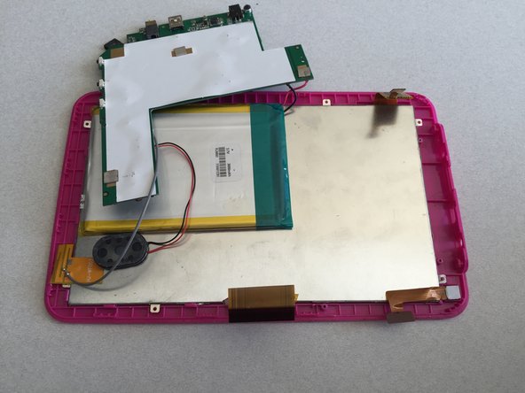

  6. Visual Land Prestige 7L Screen Replacement: crwdns2935265:06crwdnd2935265:01crwdnd2935265:01crwdne2935265:0
    • Remove the seven 4mm Phillips Head screws that hold the touchscreen panel and motherboard together.

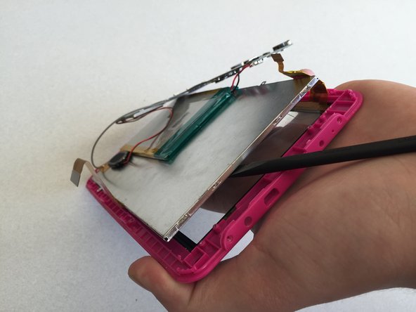

  7. Visual Land Prestige 7L Screen Replacement: crwdns2935265:07crwdnd2935265:01crwdnd2935265:03crwdne2935265:0 Visual Land Prestige 7L Screen Replacement: crwdns2935265:07crwdnd2935265:02crwdnd2935265:03crwdne2935265:0 Visual Land Prestige 7L Screen Replacement: crwdns2935265:07crwdnd2935265:03crwdnd2935265:03crwdne2935265:0
    • Gently flip over the motherboard and begin to use the spudger to pry away the touchscreen panel from the front screen.
