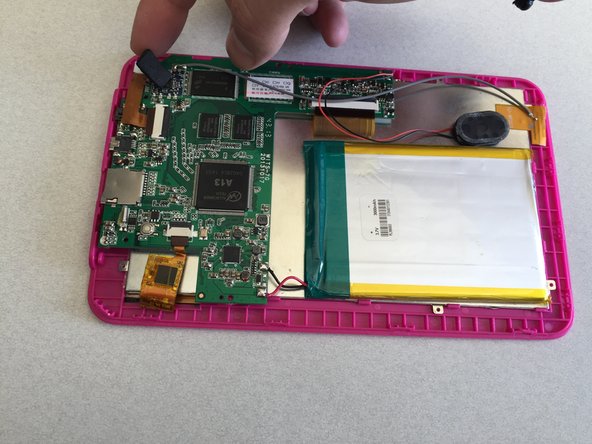

  4. Visual Land Prestige 7L Front Facing Camera Replacement, Front Facing Camera: crwdns2935265:04crwdnd2935265:01crwdnd2935265:02crwdne2935265:0 Visual Land Prestige 7L Front Facing Camera Replacement, Front Facing Camera: crwdns2935265:04crwdnd2935265:02crwdnd2935265:02crwdne2935265:0
    • Remove the adhesive padding.
  5. Visual Land Prestige 7L Front Facing Camera Replacement: crwdns2935265:05crwdnd2935265:01crwdnd2935265:02crwdne2935265:0 Visual Land Prestige 7L Front Facing Camera Replacement: crwdns2935265:05crwdnd2935265:02crwdnd2935265:02crwdne2935265:0

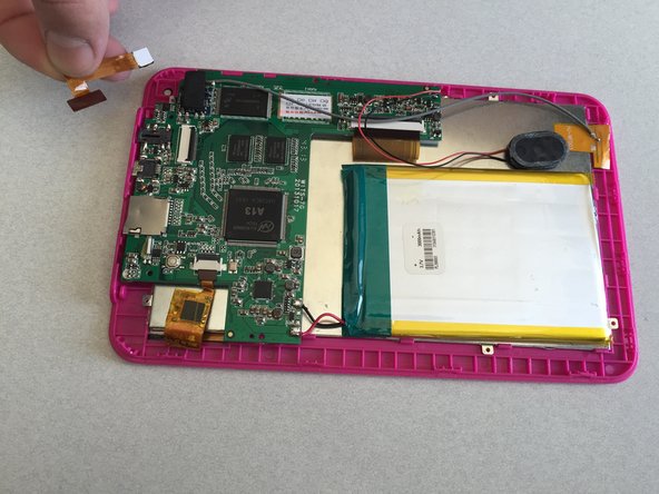

    • Unclip the connector that attaches the camera to the motherboard.
    • For more information on unclipping connectors see this How To Guide
    • Do not pull on the camera until you're sure that it's unclipped, the gold connection will rip.
    • Gently pop the camera out of the connector and off the case.
