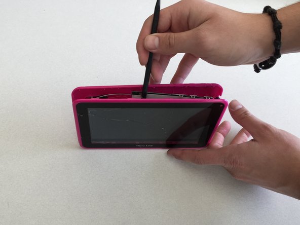

    • Insert the spudger between the two pieces of the case around the media ports and pry them apart.
    • We found the best way to get the spudger inside the case was to insert in into the SD card slot. Be sure to only insert the spudger a shallow amount and be careful not to damage any of the inside of the device.
    • Finish unsnapping each plastic piece holding the device together along the bottom.
  3. Visual Land Prestige 7L Back Panel Replacement: crwdns2935265:03crwdnd2935265:01crwdnd2935265:03crwdne2935265:0 Visual Land Prestige 7L Back Panel Replacement: crwdns2935265:03crwdnd2935265:02crwdnd2935265:03crwdne2935265:0 Visual Land Prestige 7L Back Panel Replacement: crwdns2935265:03crwdnd2935265:03crwdnd2935265:03crwdne2935265:0

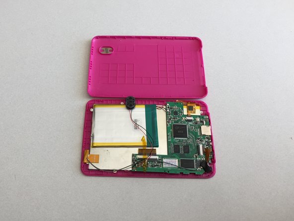

    • Move the spudger down the rest of the case, separating each side, and finally the top.
    • Pull the back off and place it to the side.
    • Without a back panel for protection, be sure place your device on the table screen-side down to avoid damaging the internal circuitry.
