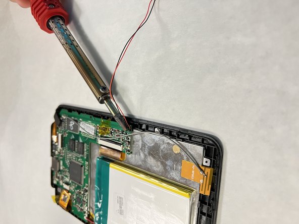

    • Lay your device face-down.
    • Use a Phillips #000 screwdriver to remove the two 4 mm screws next to the AUX port and microphone.
  2. Visual Land Prestige 7G Speaker Replacement: crwdns2935265:02crwdnd2935265:01crwdnd2935265:01crwdne2935265:0
    • Pry open the back-plate using a Jimmy.
    • Do this by inserting the tool into the fine thin line between the back-plate and screen at each corner of the device.
  3. Visual Land Prestige 7G Speaker Replacement: crwdns2935265:03crwdnd2935265:01crwdnd2935265:02crwdne2935265:0 Visual Land Prestige 7G Speaker Replacement: crwdns2935265:03crwdnd2935265:02crwdnd2935265:02crwdne2935265:0
    • Lift off the backplate using your hand.
    • If the backplate is stuck, repeat the previous step to ensure all the edges are free.
  4. Visual Land Prestige 7G Speaker Replacement, Speaker: crwdns2935265:04crwdnd2935265:01crwdnd2935265:02crwdne2935265:0 Visual Land Prestige 7G Speaker Replacement, Speaker: crwdns2935265:04crwdnd2935265:02crwdnd2935265:02crwdne2935265:0
    • Take the soldering gun and place it on the black and red wires to melt the soldered conncetions.
    • Remove the speaker.
