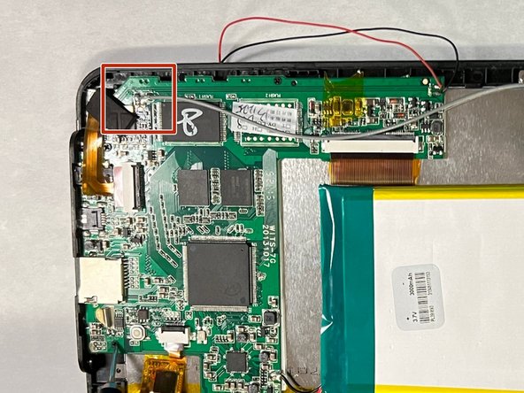

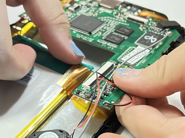

  4. Visual Land Prestige 7G Backlight Replacement, Motherboard: crwdns2935265:04crwdnd2935265:01crwdnd2935265:03crwdne2935265:0 Visual Land Prestige 7G Backlight Replacement, Motherboard: crwdns2935265:04crwdnd2935265:02crwdnd2935265:03crwdne2935265:0 Visual Land Prestige 7G Backlight Replacement, Motherboard: crwdns2935265:04crwdnd2935265:03crwdnd2935265:03crwdne2935265:0
    • Lay the device on its back.
    • Flip up the black locking flap then remove the ribbon cables.

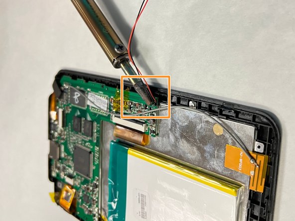

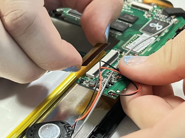

  5. Visual Land Prestige 7G Backlight Replacement: crwdns2935265:05crwdnd2935265:01crwdnd2935265:03crwdne2935265:0 Visual Land Prestige 7G Backlight Replacement: crwdns2935265:05crwdnd2935265:02crwdnd2935265:03crwdne2935265:0 Visual Land Prestige 7G Backlight Replacement: crwdns2935265:05crwdnd2935265:03crwdnd2935265:03crwdne2935265:0
    • Connected to the motherboard there will be a red, black, and grey wire.
    • Use a soldering iron to melt the soldered contact points.
    • Disconnect the wires.
    • Lift the motherboard up and out of the chassis.
    • The high temperatures of a soldering gun and melted solder may create the potential for burns. Inhaling the fumes in an enclosed environment may also lead to irritation and desensitization of the eyes and respiratory tract.

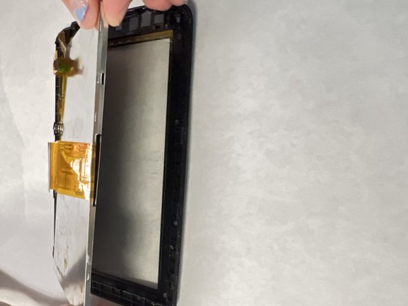

  6. Visual Land Prestige 7G Backlight Replacement, Backlight: crwdns2935265:06crwdnd2935265:01crwdnd2935265:01crwdne2935265:0
    • Remove the four screws with a Phillips #000 screwdriver.
  7. Visual Land Prestige 7G Backlight Replacement: crwdns2935265:07crwdnd2935265:01crwdnd2935265:02crwdne2935265:0 Visual Land Prestige 7G Backlight Replacement: crwdns2935265:07crwdnd2935265:02crwdnd2935265:02crwdne2935265:0
    • Use an opening tool to lift the backplate out of the case.
    • Pay close attention to the black tabs holding it in, making sure not to break them.
